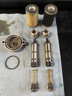

I just wanted to say, (as you probably know!) the 400 engines have the usual oil filter and two screen filters, one in the drain plug and (I think) one “nearby”. Also from posts on the Triumph 400 forum, I believe KTM 390 filters fit as both bikes are built by Bajaj.

Thanks for the info, searching on the KTM 390 filter came up with a bunch of hits. I was able to order 6 filters for $24.
Good stuff - I haven’t done this job myself and was just passing on info from 400 forum, but they are a pretty reliable bunch !
