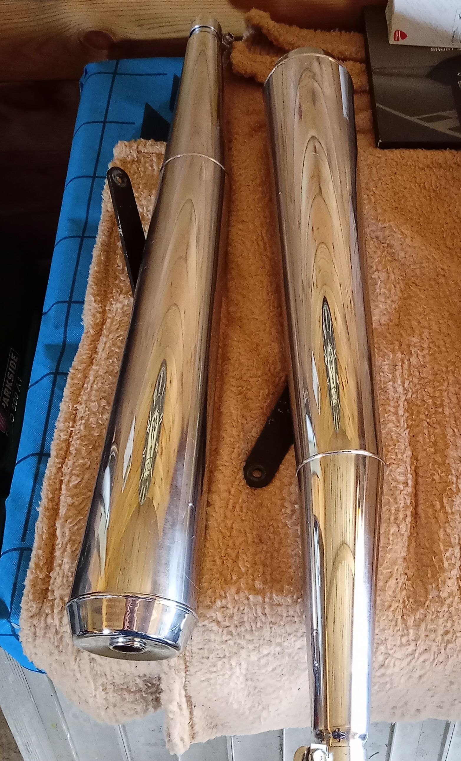

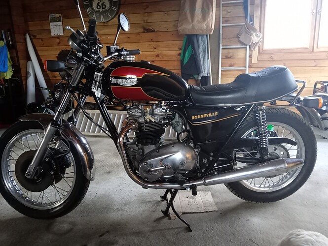

Anyway the first parts I found where the ultra rare original Lafranconi exhausts. You occasionally see a left hand one for sale (don’t know why) but I found a pair, possibly the last on the planet being sold by an ex Harris dealer who had kept hold of a few parts after he retired. I bought these before I’d even agreed to buy the bike.:grin:I’ve only trial fitted them to date. For some reason I’m reluctant to run the engine with them. I’ve also replaced the headers which where the none linked performance type with the original type. Interesting that I sold those for more than I paid for the new ones.

Bear with me cos’ there follows a series of pics showing the Harris special parts.

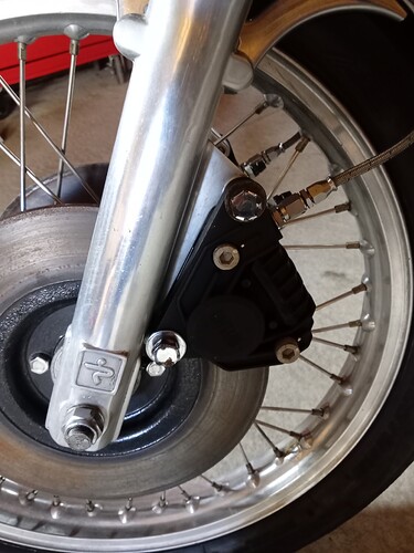

These are the F08 Brembo calipers and the Paioli forks. 38mm rather than the T140 35mm. Even the discs are slightly larger than T140 standard.

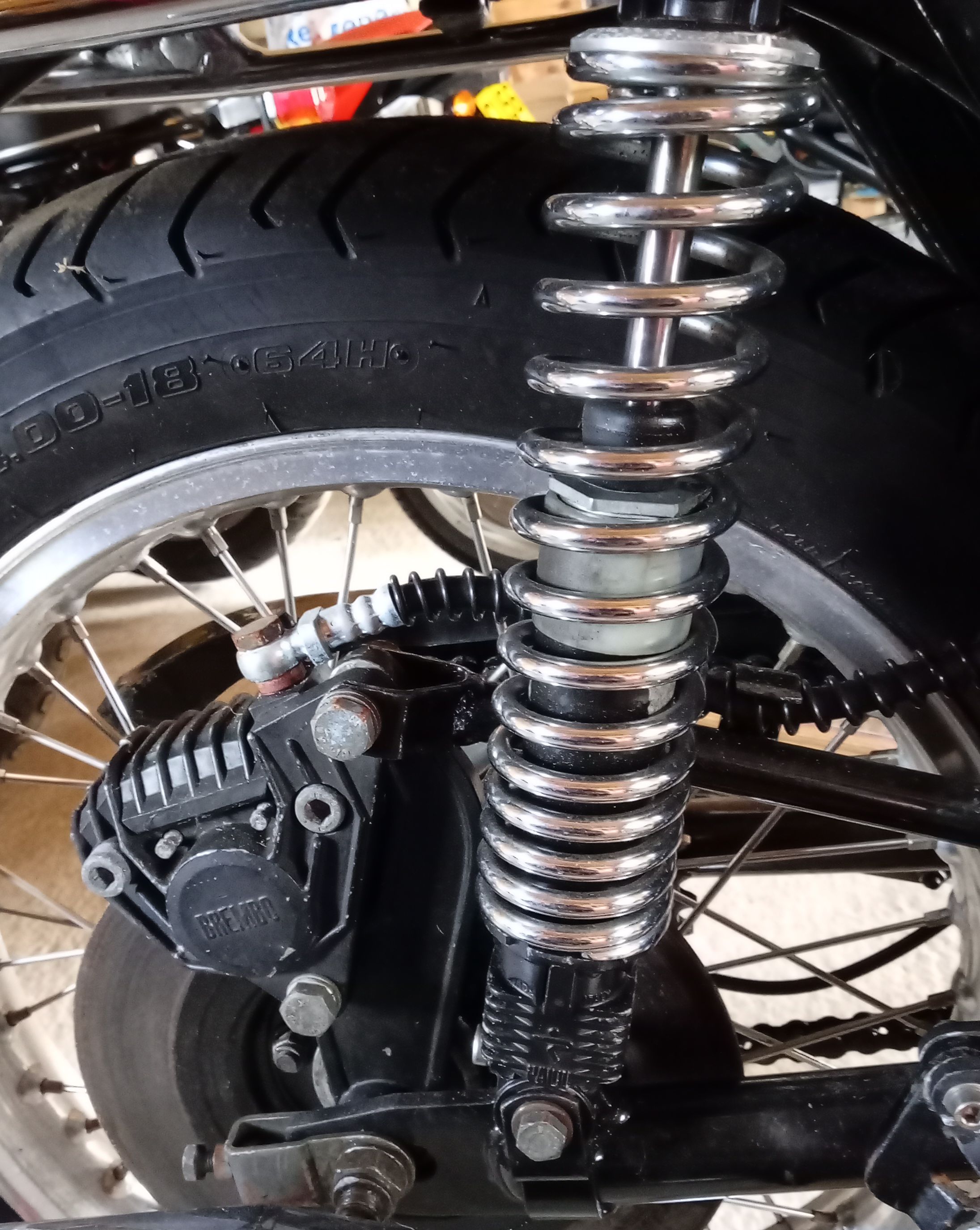

And the rear with the Paioli shocks.

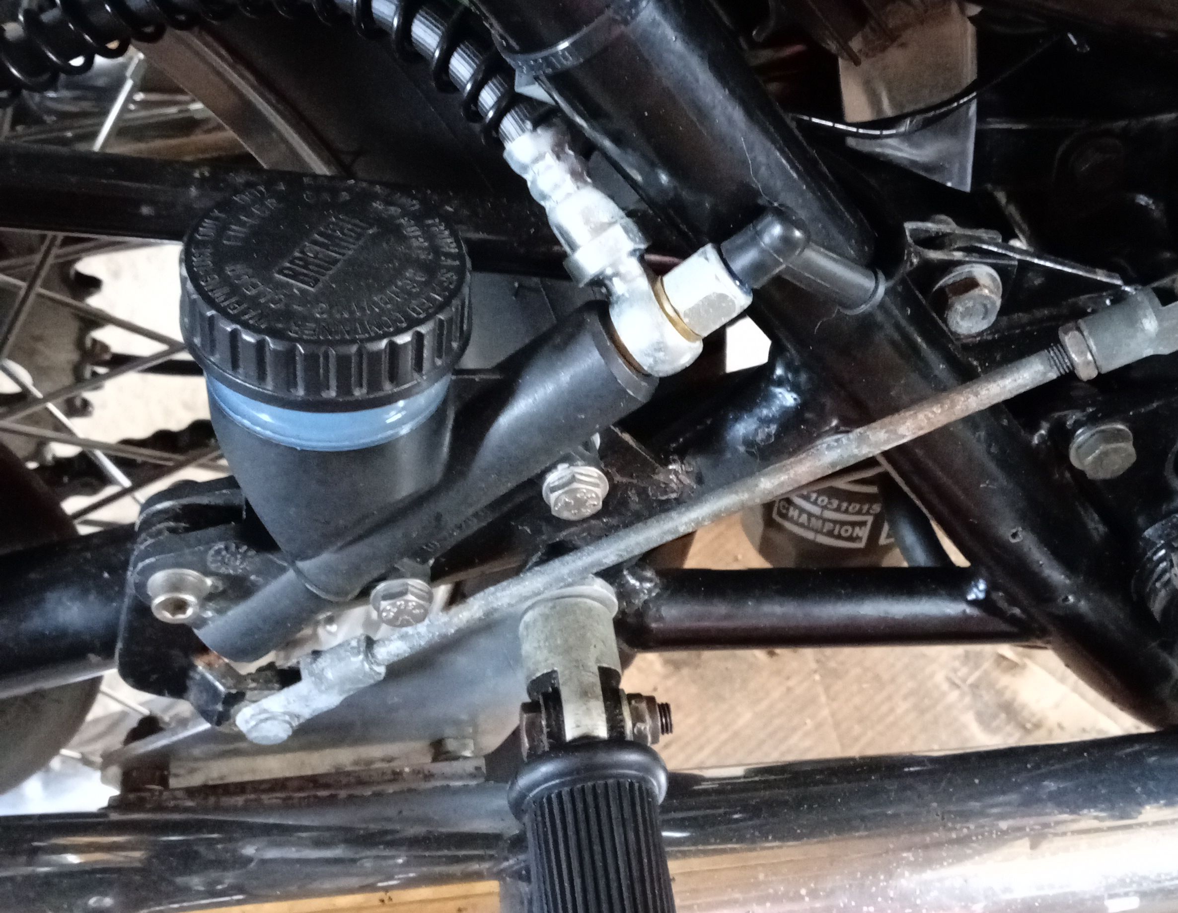

And Brembo rear master cylinder.
Lafranconi exhausts and special brackets.

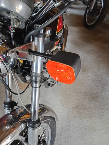

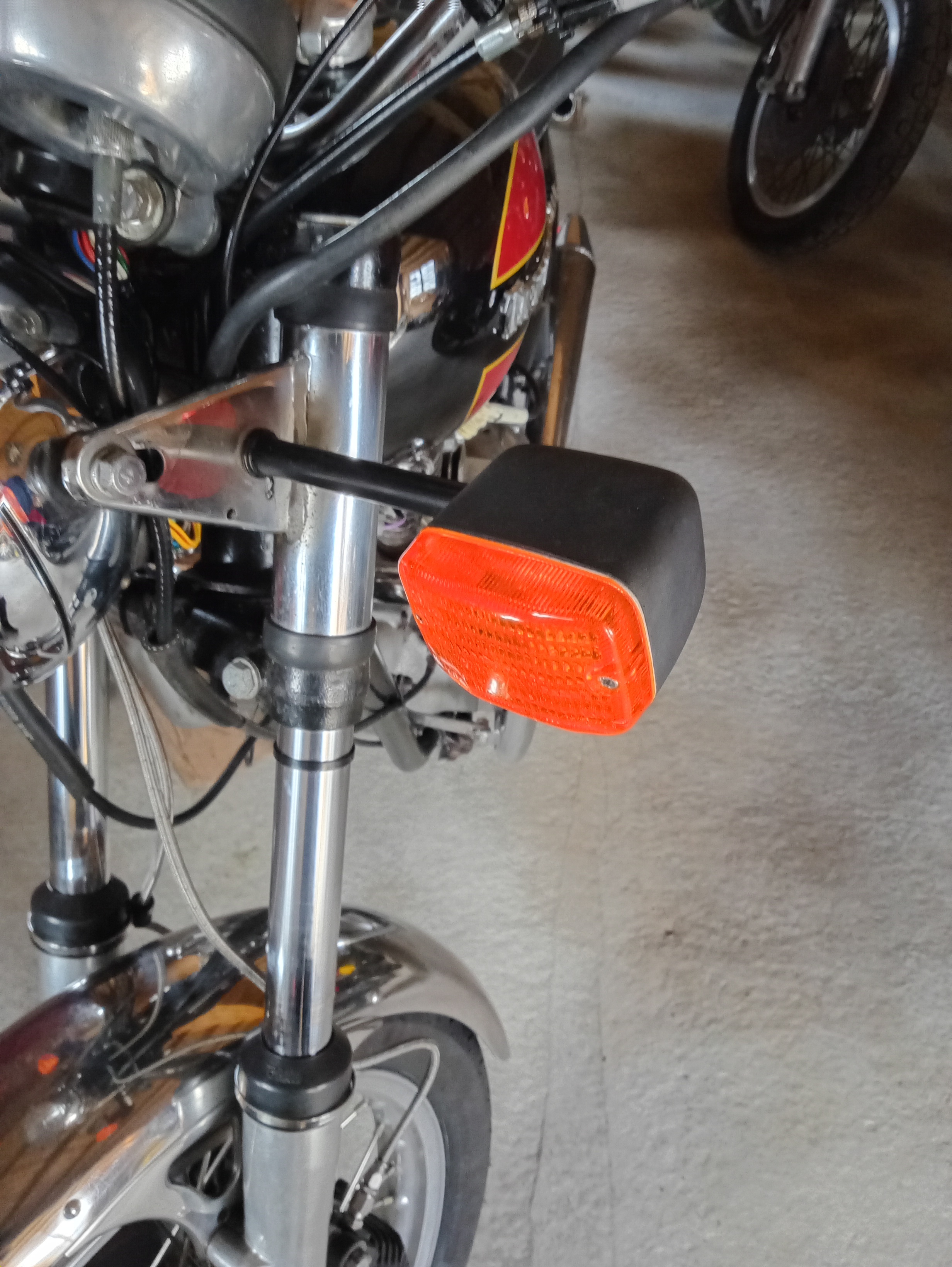

The really expensive cheap plastic indicators (I’m not bitter):rofl: and showing the slightly beefier forks.
Oh and Stainless steel mudguards front and rear.
That’s all for now. :grinning_face_with_smiling_eyes:

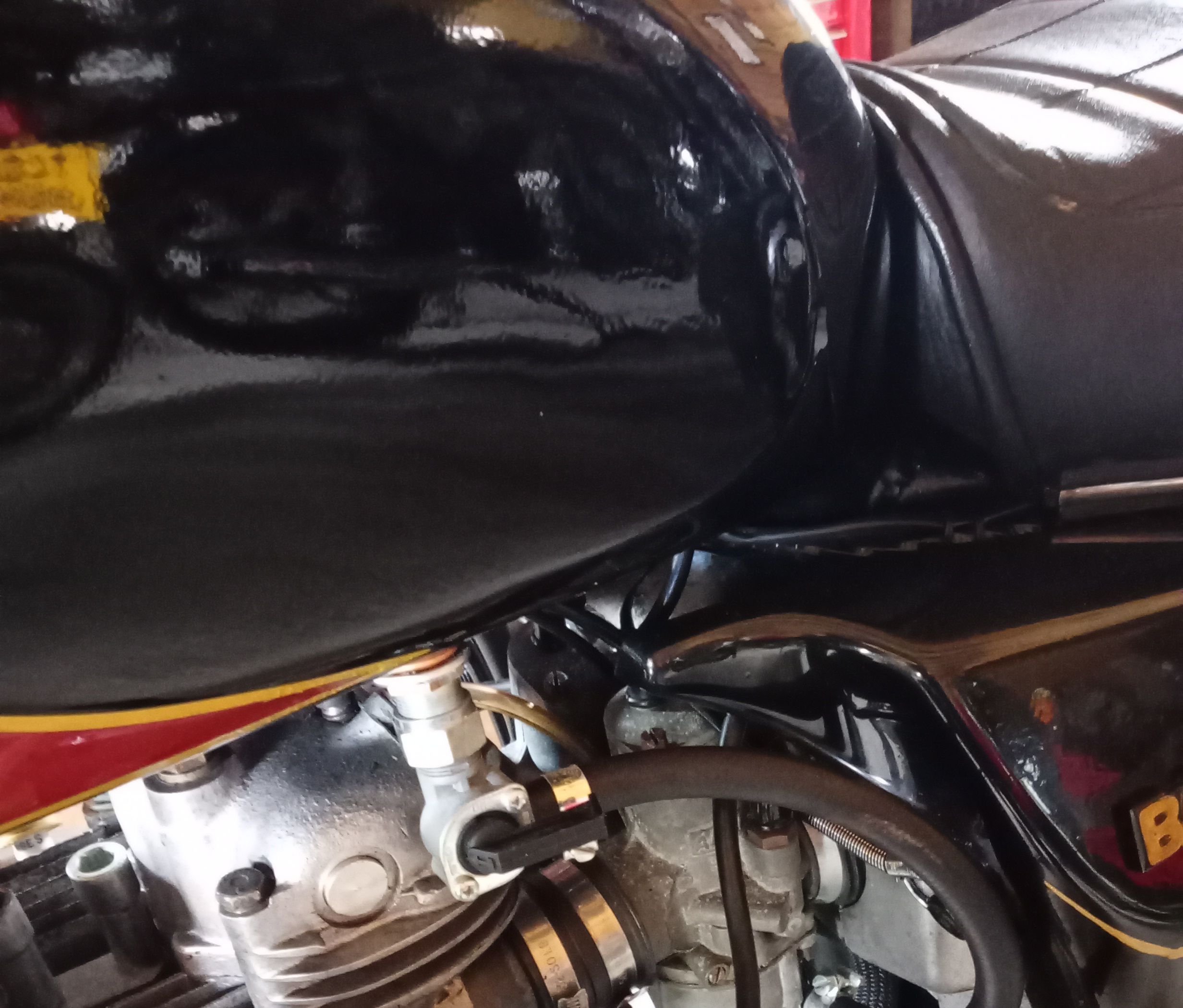

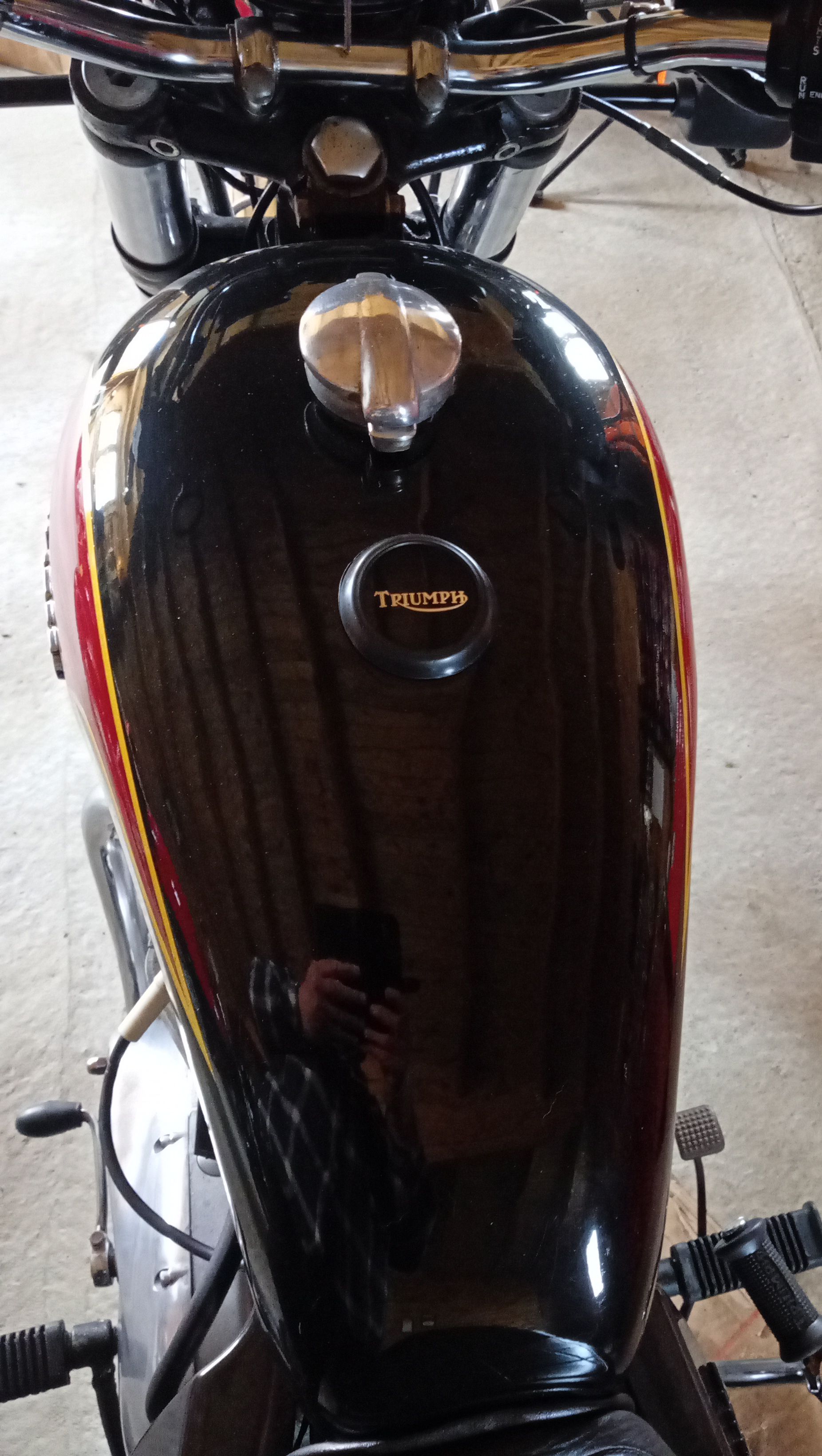

The tank’s quite interesting. Les had these made in Italy.
The first thing you notice is the filler is in the middle rather than offset to the right. And the Monza cap of course.
And the Paioli taps are set further forward than with the Triumph tank. The reserve function doesn’t work as the adapters are so long it drops the pipe so low, out of any useful volume of petrol. Apparently it’s the same with the T160 that used the same taps. I know of someone on a T160 went on to reserve on a motorway and didn’t make the 10 miles to the next service station.:grimacing:

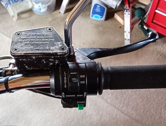

I bought the switch new from Hawkshaw. But the Master cylinders are impossible to find. There must be dozens of them chucked in the back of sheds because for a long time the rebuild kits were unavailable. Anyway I managed to find this one off, I think, a Moto Guzzie Mille. It’s the same 2 piece m/cylinder but with a different reservoir, the Harris should be a round plastic job. It’ll have to do for now. I’ve learned to never give up.

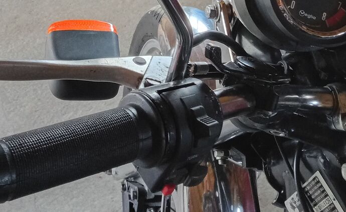

This switch was broken and they’re not available anymore. This switch is for a Royal Enfield and just for fun was wired completely differently to the Harris. Fun and games were had I can tell you. It came from a used parts dealer in the USA.

The front calipers had a rebuild kit but I couldn’t get the joint to seal. It has an o ring between the Half’s and it wasn’t leaking fluid but bubbles were appearing so I got a new pair of calipers from an Italian supplier. Again I can probably fix the old ones when I get around to it. After that I got the pistons out of the rear one without splitting it and replaced the seals. And that worked fine. Apparently it’s common for the joint to leak after they’ve been split. New seal kit went into the rear master cylinder. These are a nightmare to blead as there is not enough movement in the lever. I ended up taking the whole thing off with the pipe and caliper and hanging it on a hook and manually operating the short lever. I took the opportunity to replace the rubbish stop lamp switch with a hydraulic one at the same time. Phew, this is going to take a while.:grinning_face_with_smiling_eyes:
