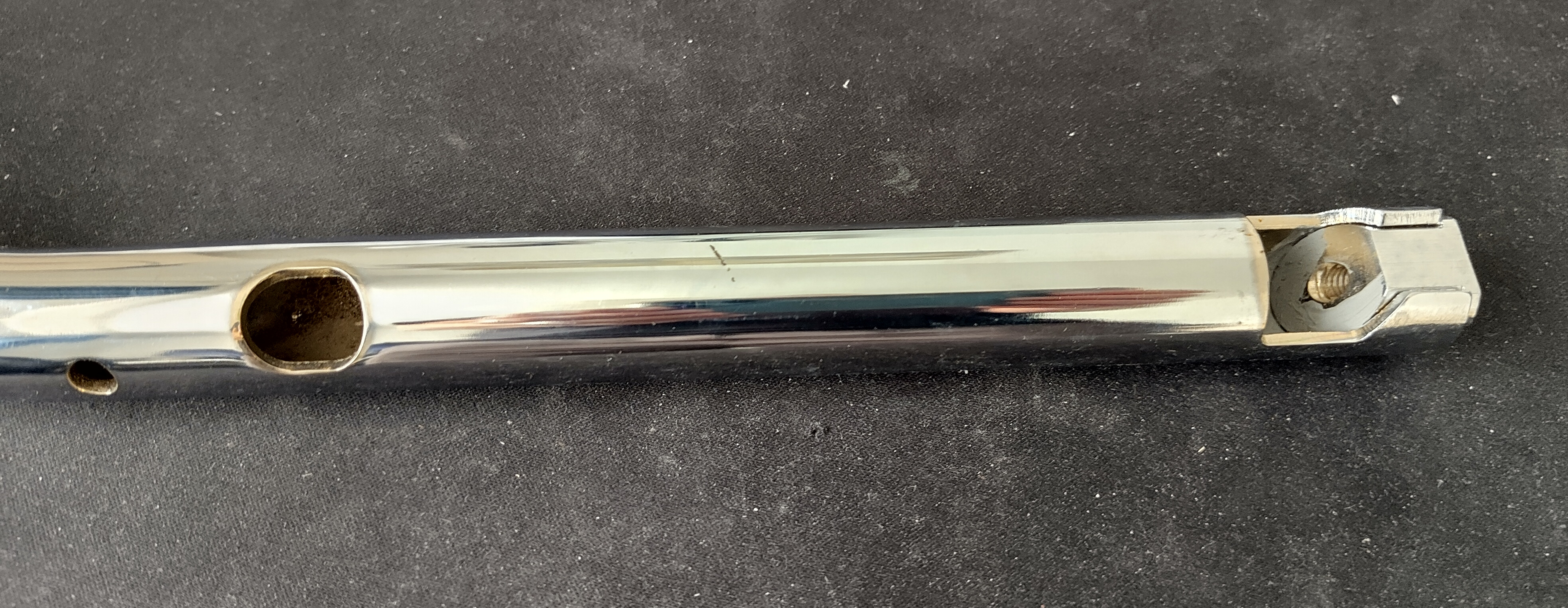

I read somewhere that it isn’t possible to retain the heated grips and bar end mirrors if you change the bars to a tracker type bar.. Not sure why , but something to do with the bars being threaded in the ends to accept the mirrors??? is this correct???

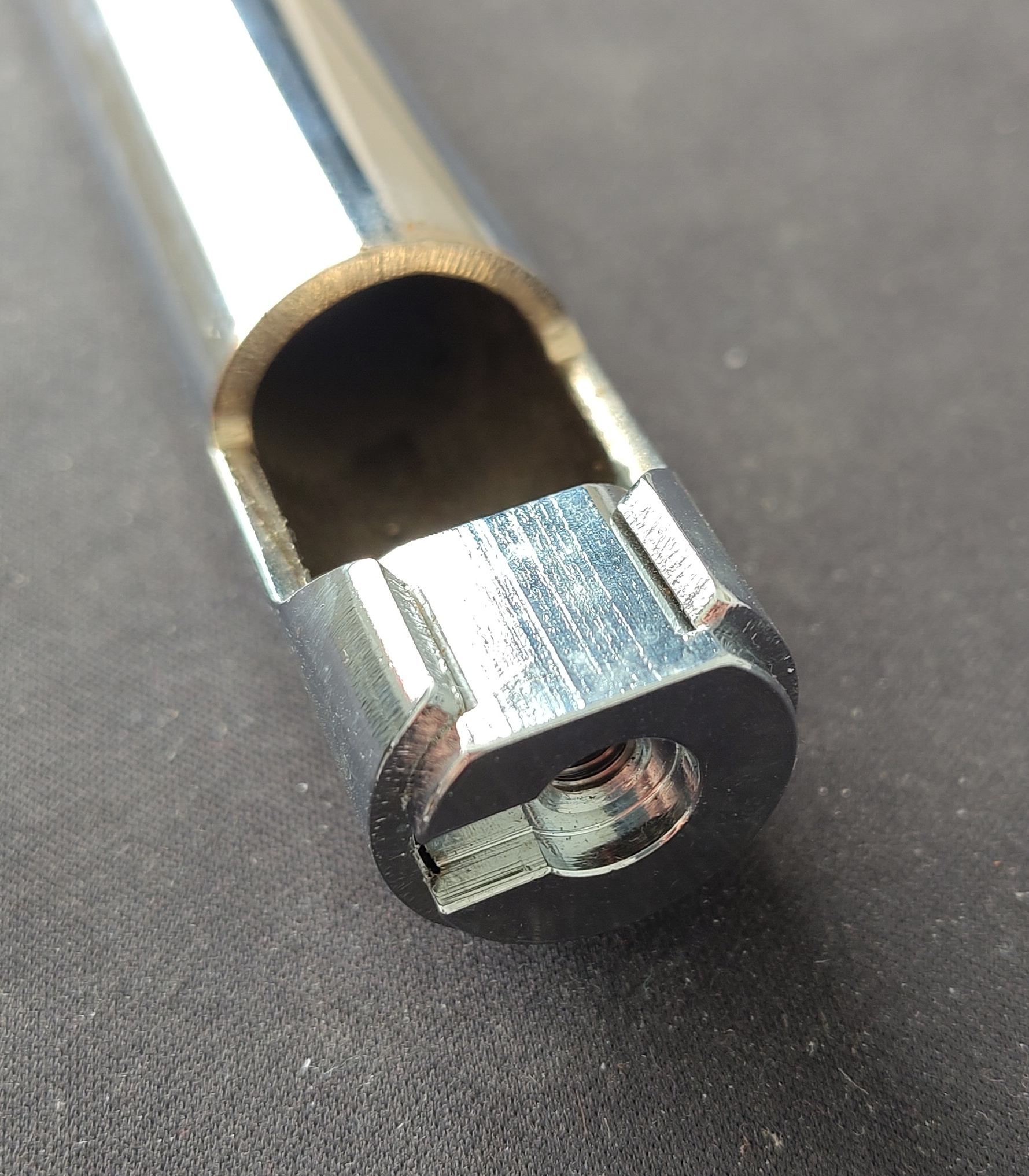

I don’t know about other handlebars, but this is what the Triumph 1 inch bars look like…
The end has a threaded insert fixed in with a slot too, presumably for stopping bar end mirrors rotating.
The hole next to that insert if for the wires from the heated grips to go in.
Those wires come out the larger hole on the left of this picture, which is where they connect inside the switchgear.
Note the smaller hole to the very left. That is where the peg in the switchgear housing fits to stop it turning.
If you were changing handlebars and wanted to keep Triumphs heated grips and bar end mirrors you’d need to cut some holes and find an insert for the bar end mirror. I’ve never had bar end mirrors but I’m sure I’ve seen expanding inserts to mount them in plain tube bars.
Wow what a way for triumph to make it hard for anyone to change their bars…
