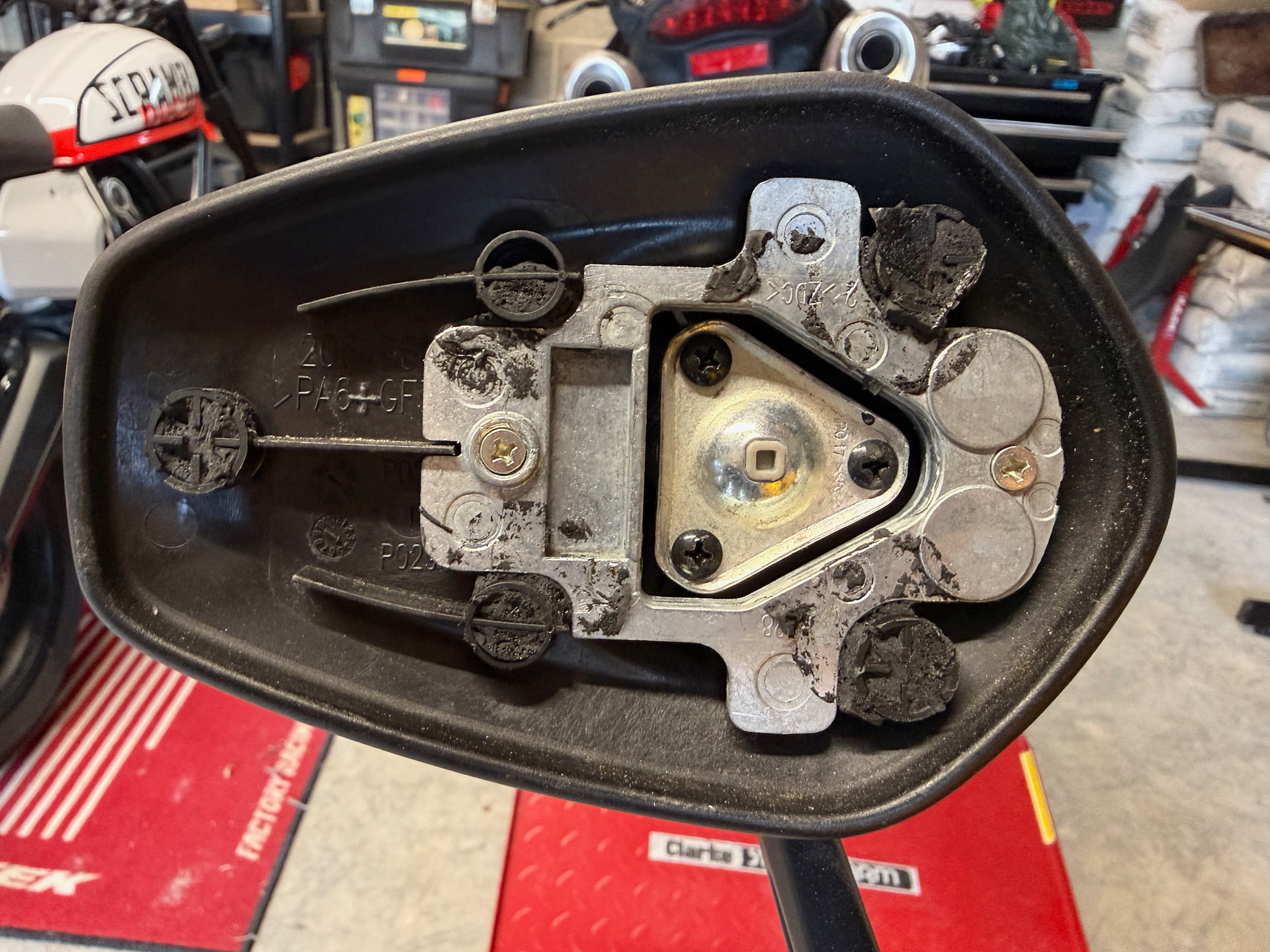

Being a bit slow, I realised later rather than sooner that the replacement glass may not work. I’d have to remove the cracked mirror to tighten the screws behind (assuming that’s how they’re made). It says the cut-to-size replacement stuff sticks over the old mirror but perhaps it can be glued in. Can’t tell without seeing it first hand.
I’ve got nothing to lose now so I can at least find out how they’re put together.

In further news about the current pair, I’ve picked out the bits of broken mirror. They’re stuck in with a quite tenacious sticky pad but underneath that…
Well would you look at that. Three screws that tighten the mirror on the ball joint. :roll_eyes: This must be fixable. All I need is a piece of glass the right size and shape and some sort of sticky stuff to keep it glued in place.
Or a piece of perspex that’s easy to cut and file yourself to the correct size, then some of that stick on reflective stuff for mirror repair mentioned earlier.
Ah yes. That’s an idea.

You could use a piece of cardboard to make a template and try a glass shop to see if they can cut a mirror for you. Just a thought.
That sounds like a sensible plan. I’ll look in to it.
