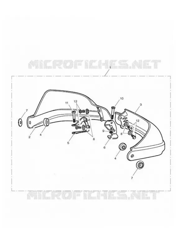

Can you identify them from here?
Superrr. I could not find that. I need bolts number 10 and 11. Thank you very much
I think 10 and 11 are the longer pivot bolts for clutch and brake lever. You said you needed 4 bolts…they might be the M6 x 16 bolts listed as no 12
