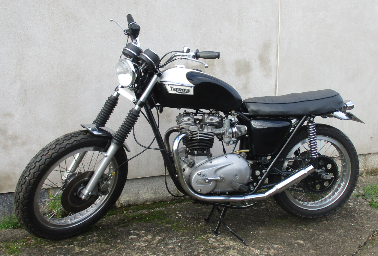

1978 Bonneville Project

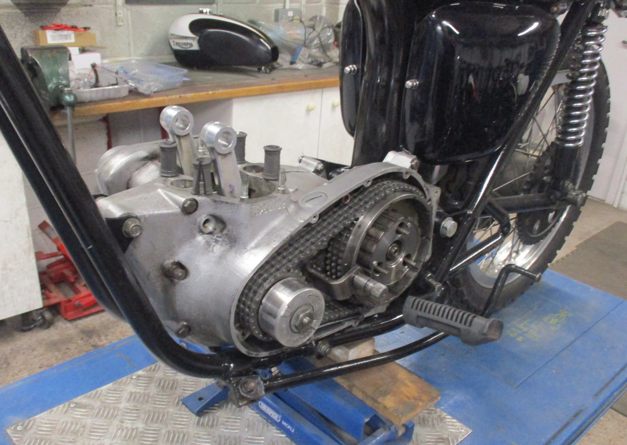

Bottom end of engine back into the frame.
New riveted type main bearing rather than the original spot welded type.
New sludge trap and plug, shell bearings, clutch, primary chain etc etc etc.
Always, always, when buying one of these, almost 50 year old motorcycles, account to go for the sludge trap. It’ll cost about £200 just in gaskets, oil seals, and bearings etc. without any parts that may need replacing but at least you’ll know if it’s healthy.

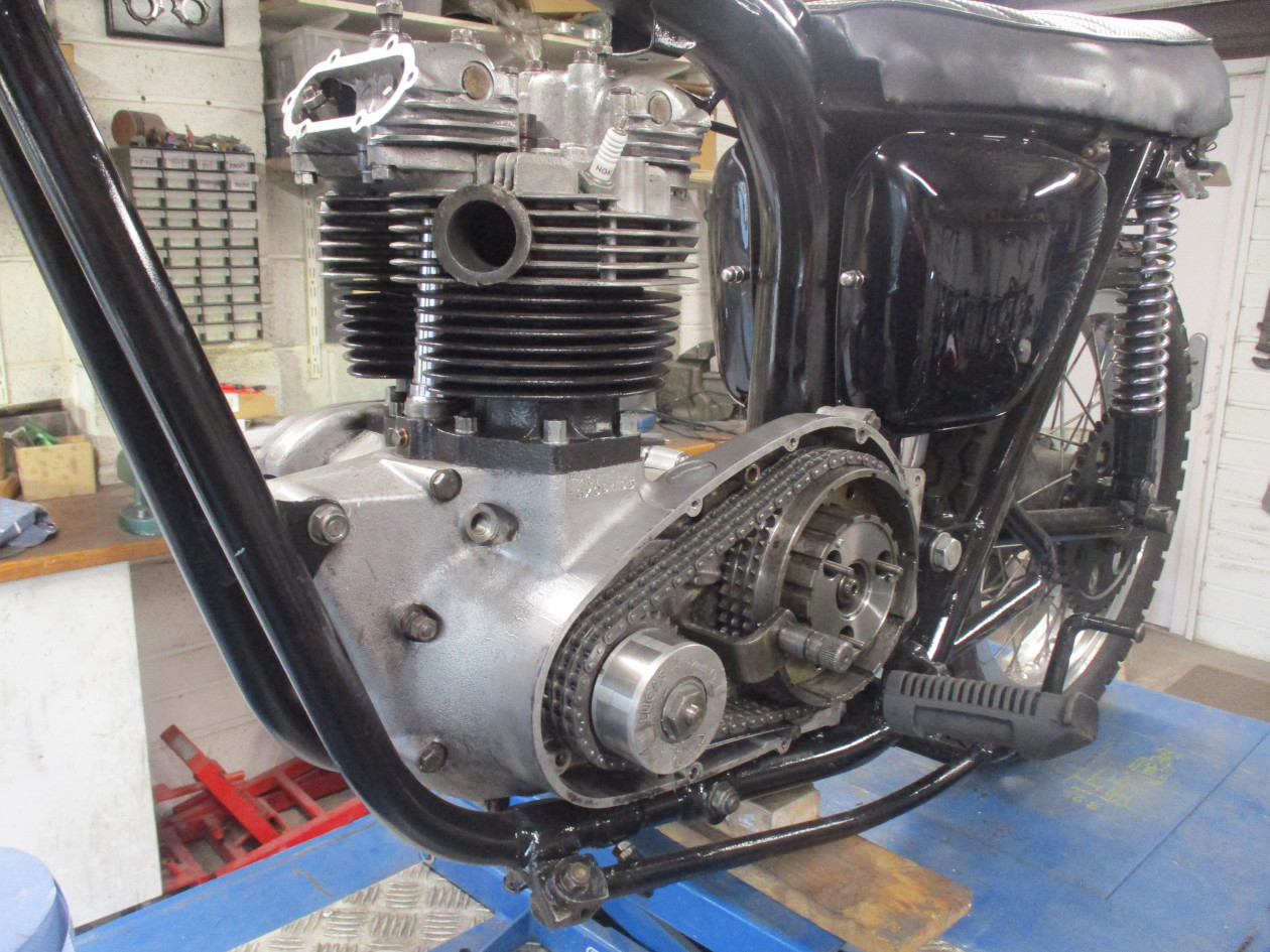

Top end almost complete.

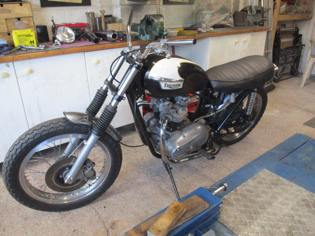

Engine build mostly complete…
Carbs, brakes and a few brackets to make - zorsts, ignition switch, clocks and headlight. Then onto the wiring, oh joy. Ordered a few bits and bobs but hopefully a week or so.

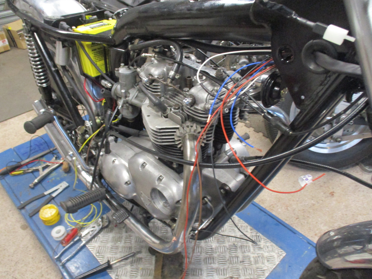

Wiring…
…burned myself twice with the soldering iron. Such fun. :neutral_face:

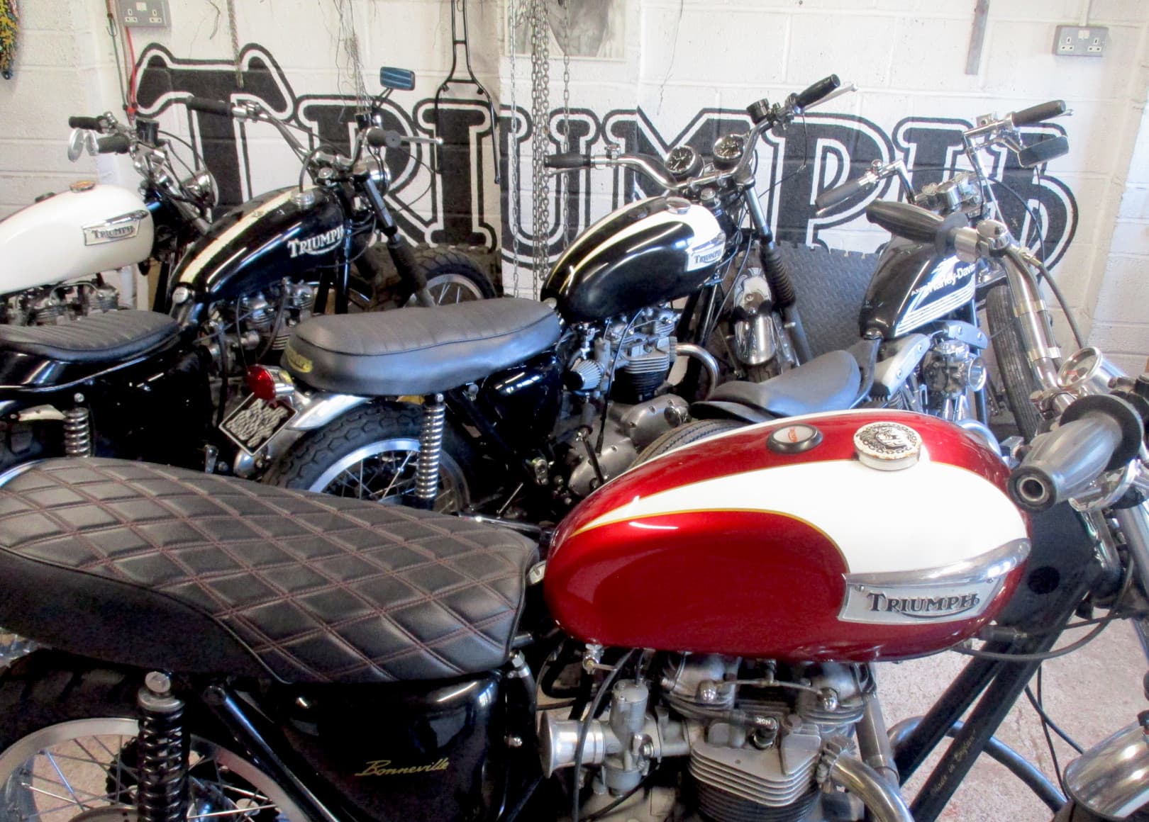

Done:
Starts, runs, electrics all work, gears all work, sorted and ready to go.
I’ll keep updated on auction details on all three bikes when I know.
Thankee…over :slightly_smiling_face:

If the sun comes out and dries up the mud in the lane I’ll get some photos, if not I’ll try to get some of them going on the van. I’m assuming they’ll all go together, and soon - hence my hobbling around trying to get this one done. I’d rather only pay for one delivery trip - the way the prices have gone on these old farts, I’ll be glad to be in the black to give me enough for the next planned project. :neutral_face:
The bike looks fantastic, a very very beautiful job @Iron .
Thanks gang. Given the oncoming cold, this may be the only chance of them all together under the Triumph Muriel
That’s eye-candy, right there! :smiling_face_with_three_hearts:
Very nice dude, you should have a professional shoot… an engineer and artist!
I am still coveting that red one.
Sorry, keeping the red one. T’was my first, a jubilee year bike, it’ll end up on display on a shelf when I can’t kick it over any more.
