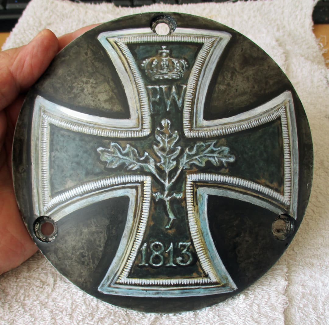

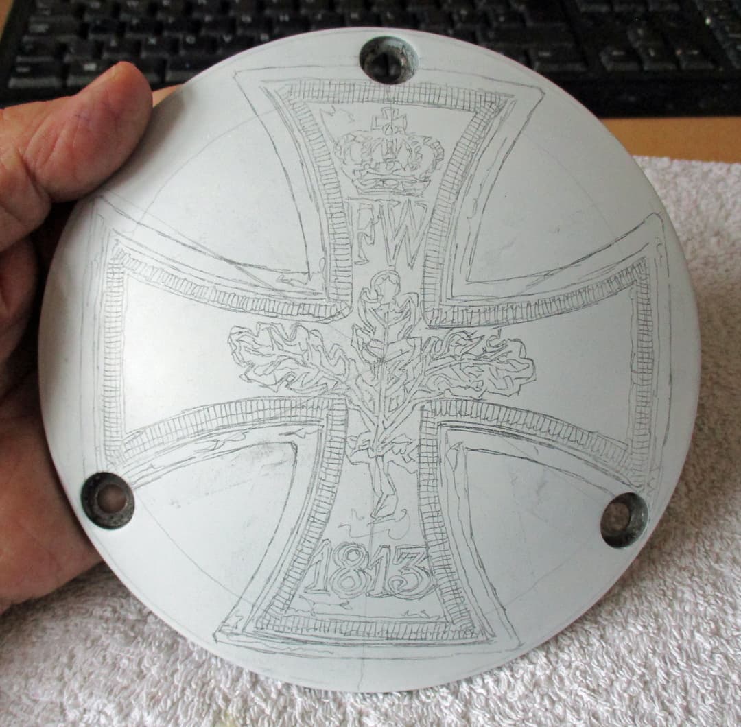

So having another go on a spare derby cover
and just before the craquelure base coat
diving in, wish me luck as that hammer drawer isn’t too far away :slightly_smiling_face:
I wasn’t aware of the significance of the initials FW and the year 1813 - I have now educated myself and found out 1813 was the year Frederick William III established the Iron Cross Award… :see_no_evil_monkey:

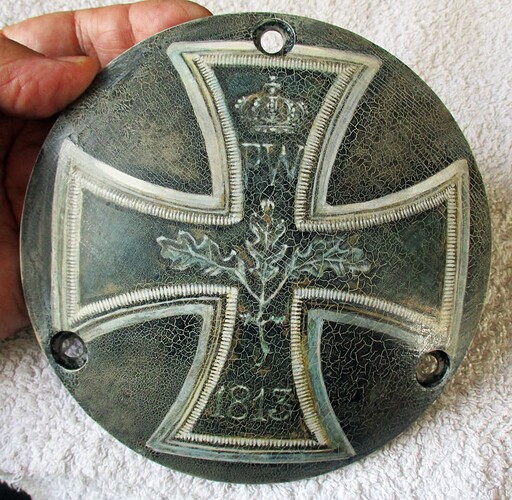

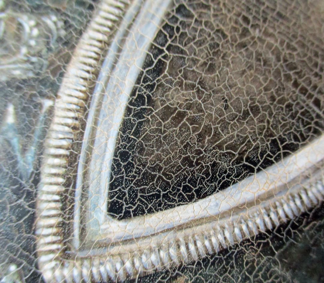

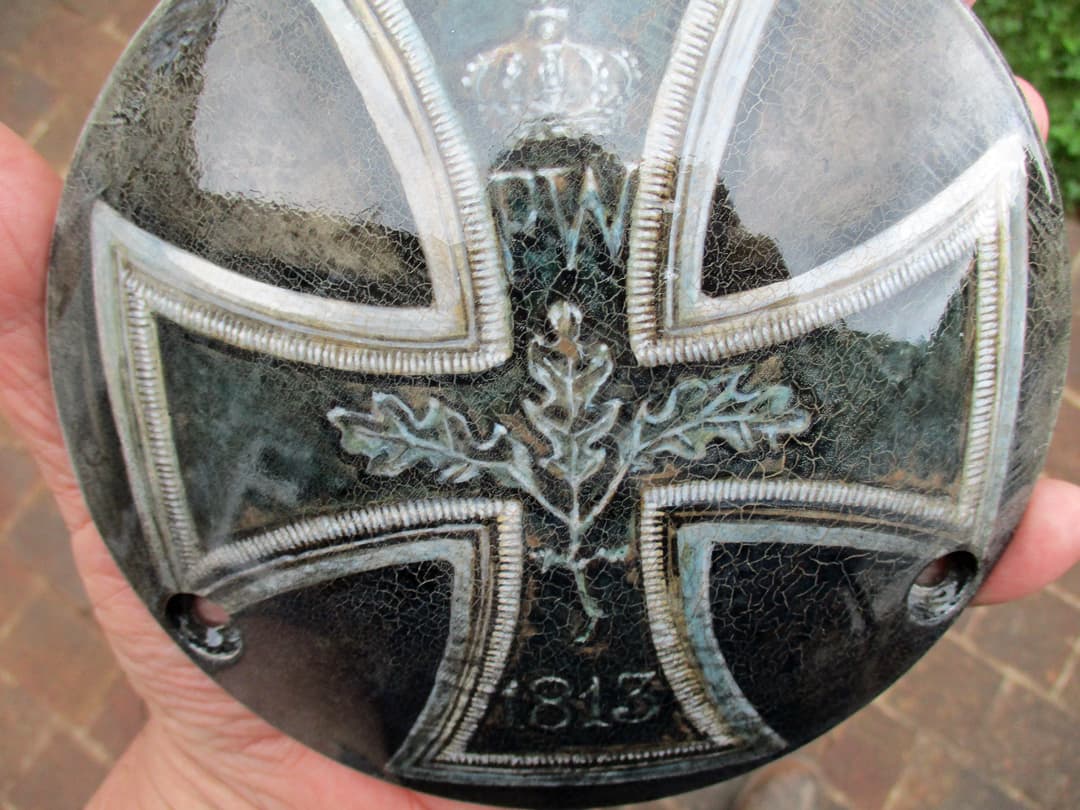

I think I’ve figured out that I hadn’t allowed enough time for the base coat to dry as it remains tacky even when dry.
It looks ok once the cracks are highlighted but probably better on a lighter base with darkened cracks.
miles better than the hobby crackle stuff as it properly looks old.

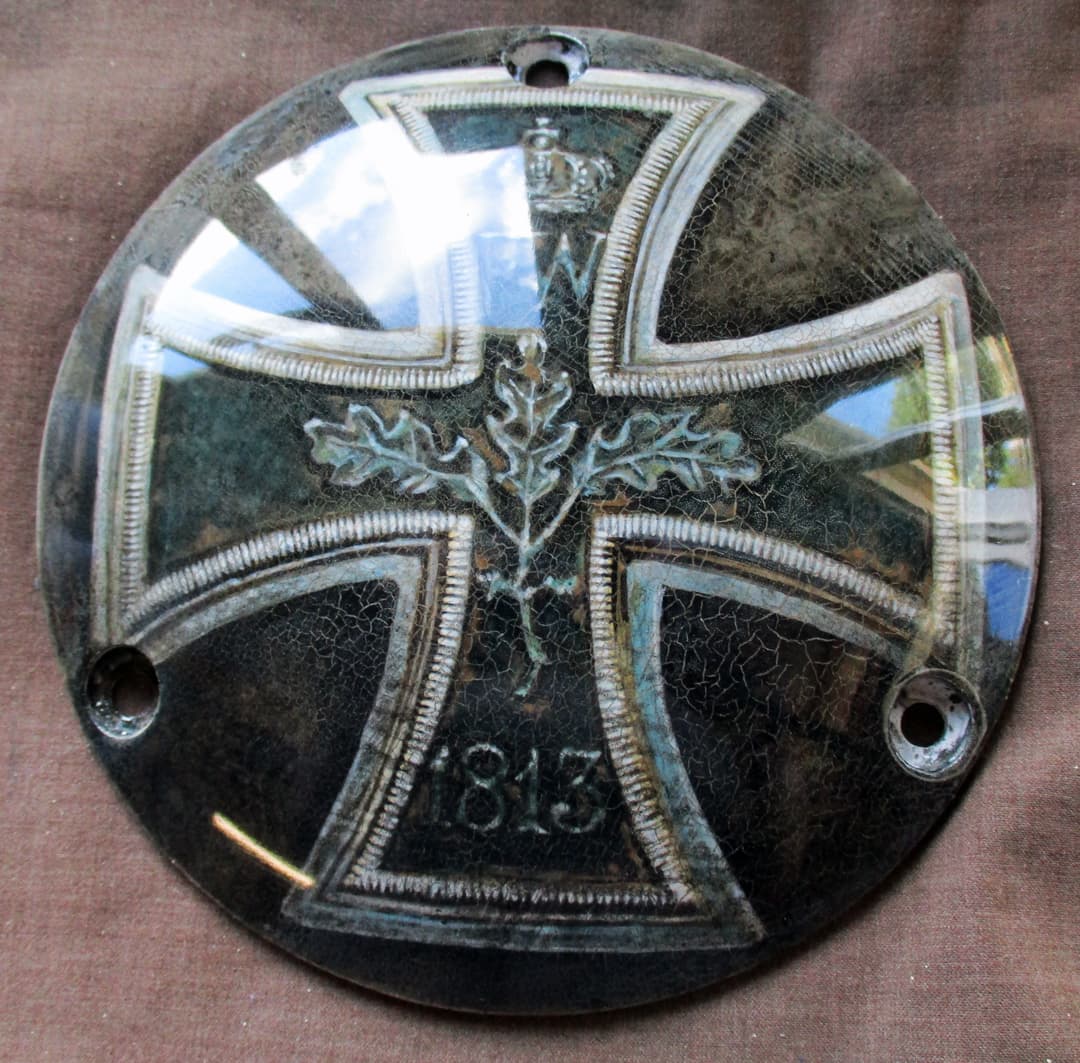

I’ll now see if the 2k clear coat goes on ok.
I think I’ll try thinning it down and try the air brush application again. It’ll lose the brush marks if I can get that to work. Fun fun fun… :slightly_smiling_face:
2 pack went on pretty well. As usual it removed some of the mistyness from the underlaying layers.
Applied two pretty thick coats.
Difficult to photo due to reflections but looks ok. I’ll polish it tomorrow and stick it on the bike.

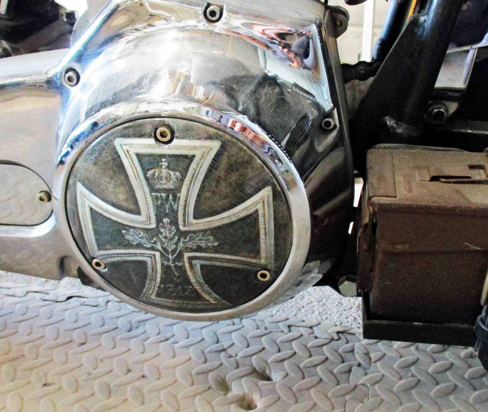

Polished

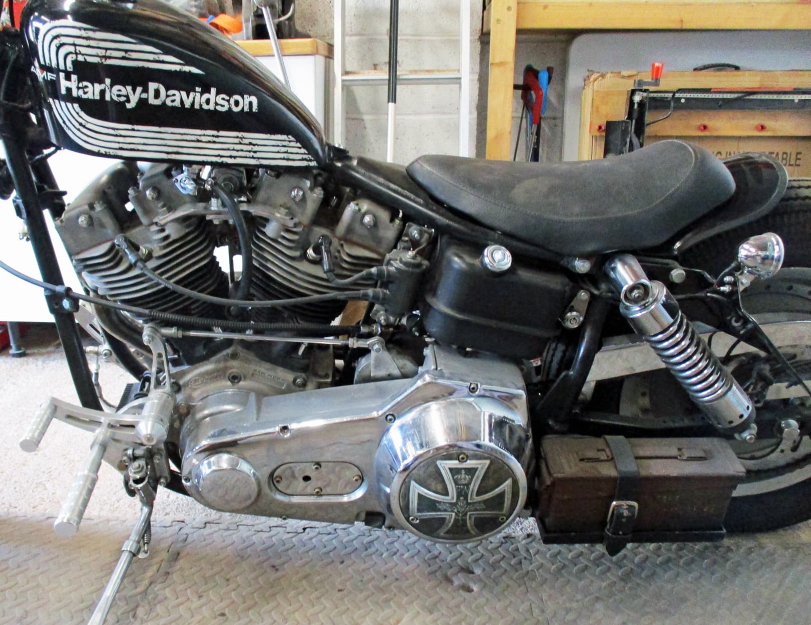

and on the primary
must get out and blow the dust off

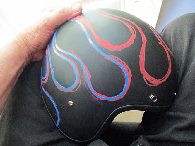

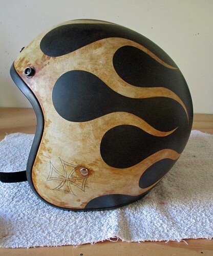

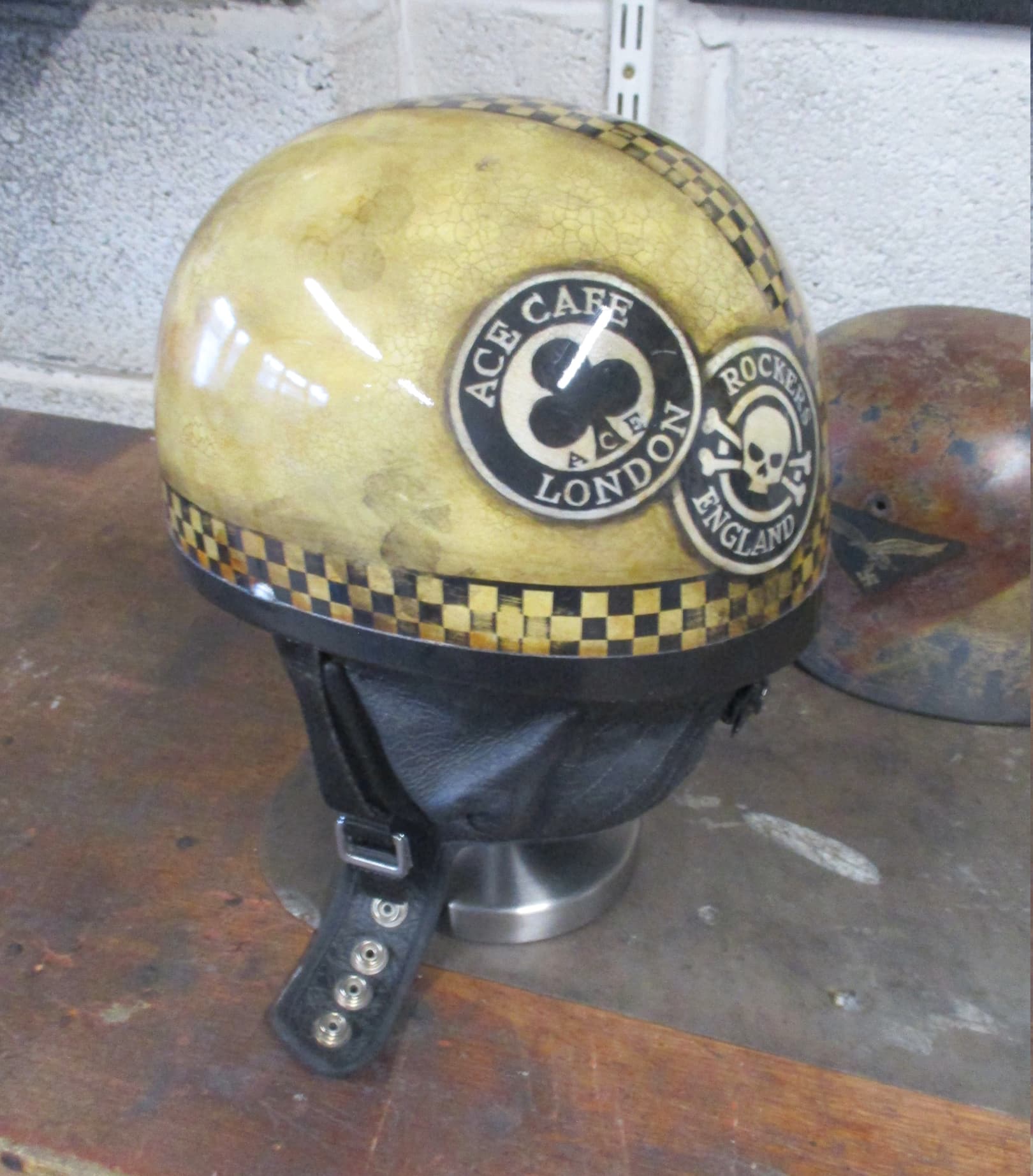

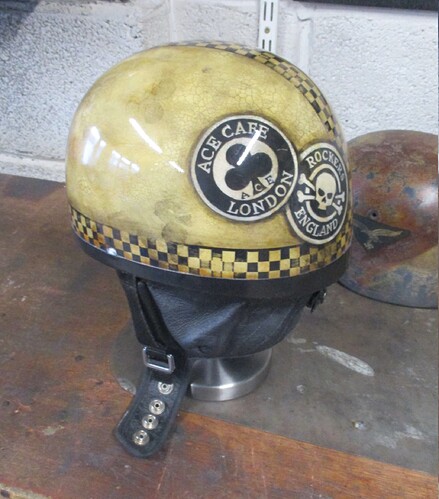

Sketch on some flame shapes to aid the tape placement

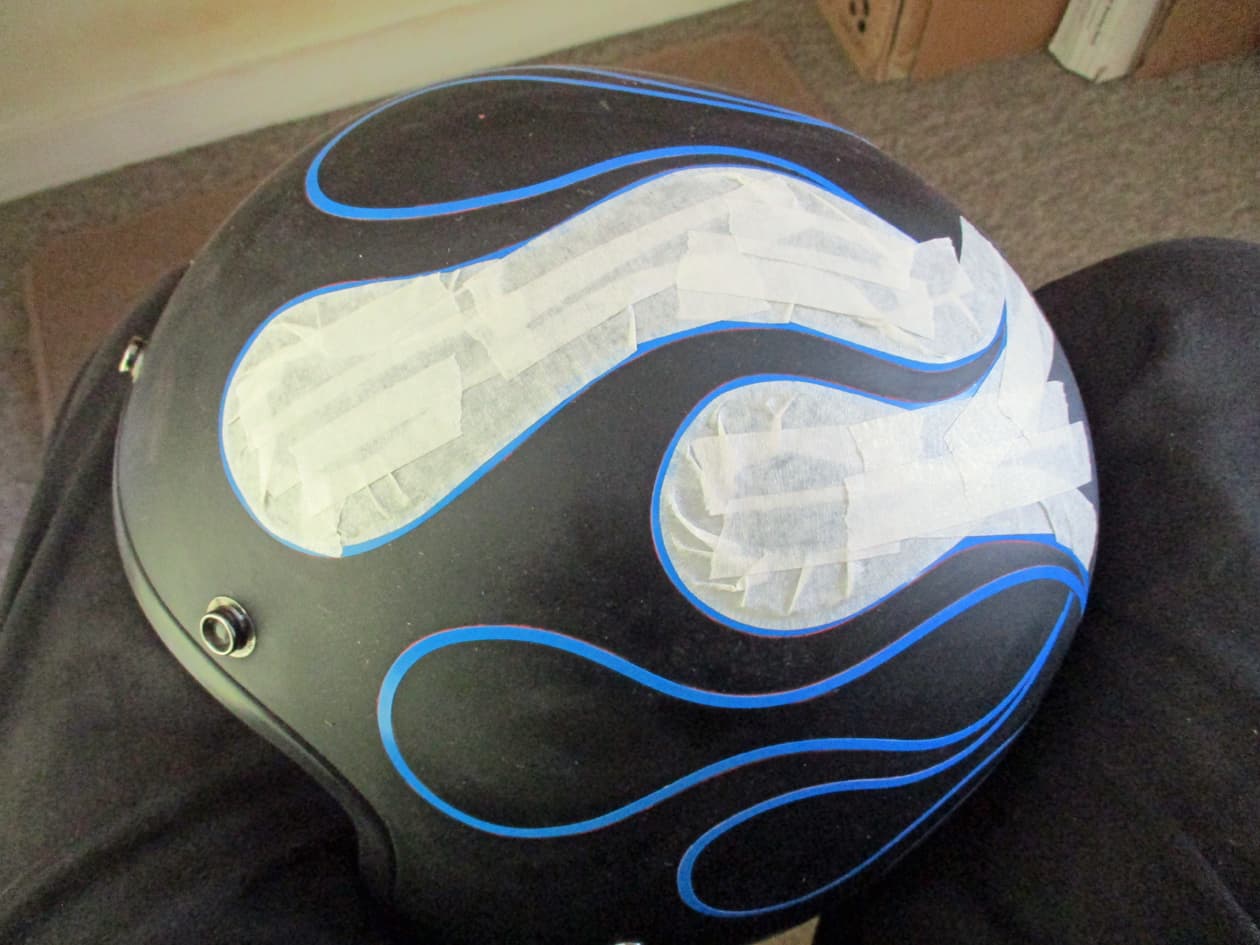

Mask off the black

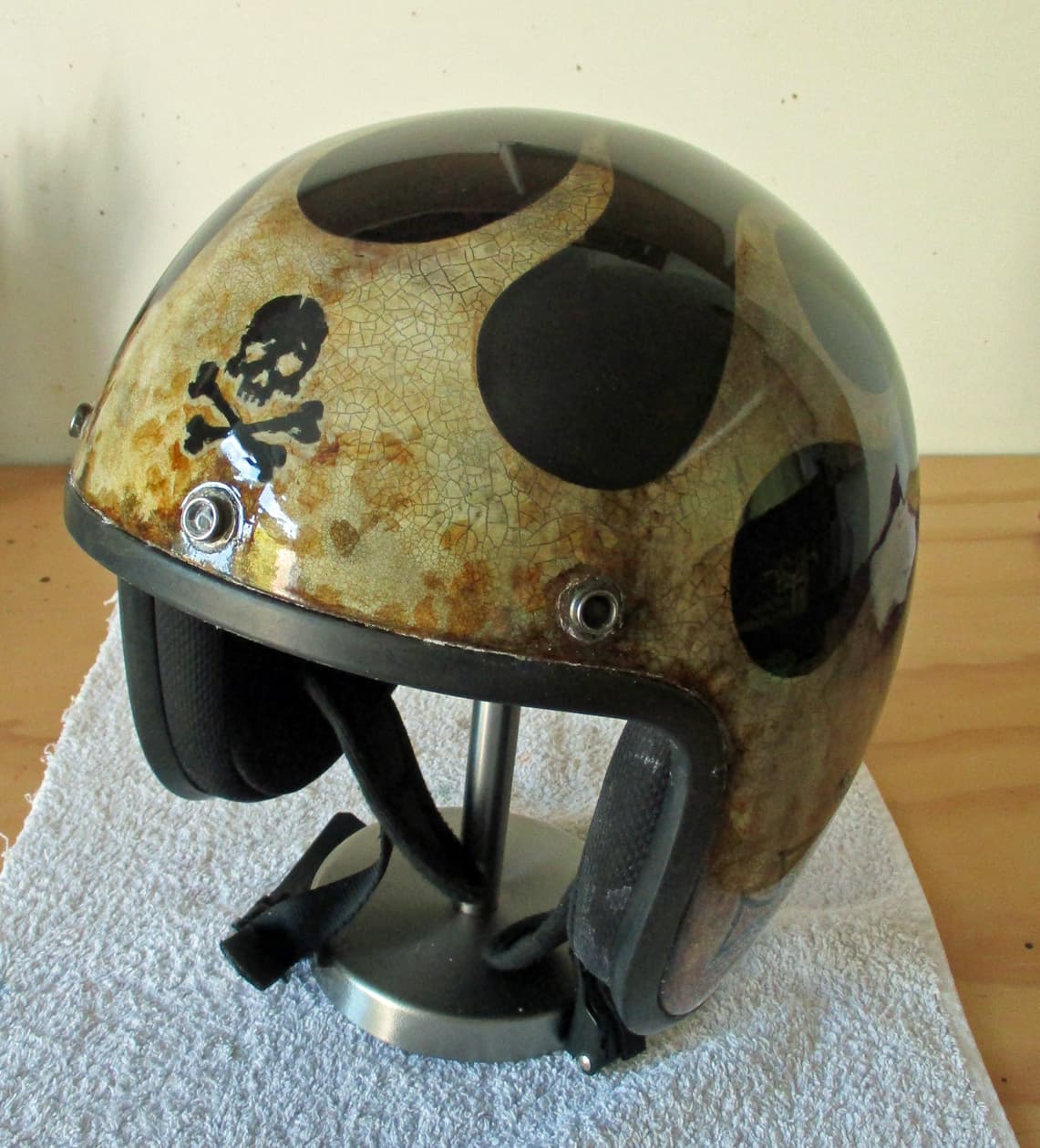

Spray white and tone down with some muddy colours. Add a sketch of an iron cross and…

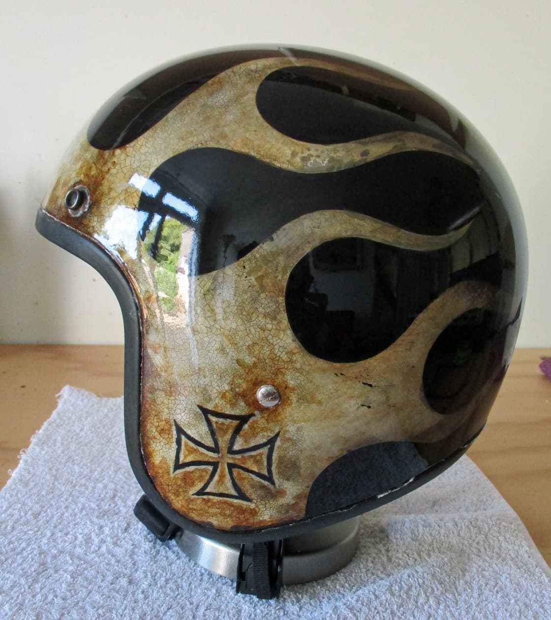

… a skull and crossbones. Then time for tea, will complete at a later juncture (probably in the morrow as it’s gonna be too hot again for the garage).
Gotta sort out the masking on the rubber edges and some polishing but there or there abouts

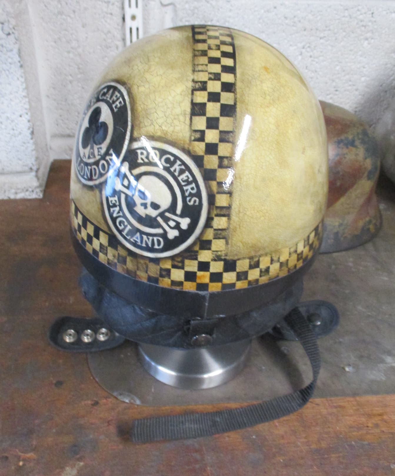

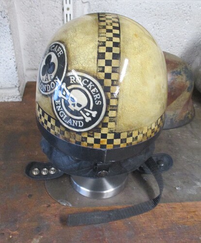

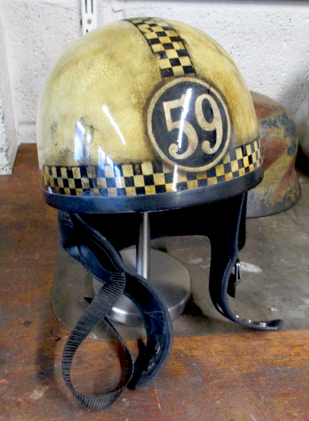

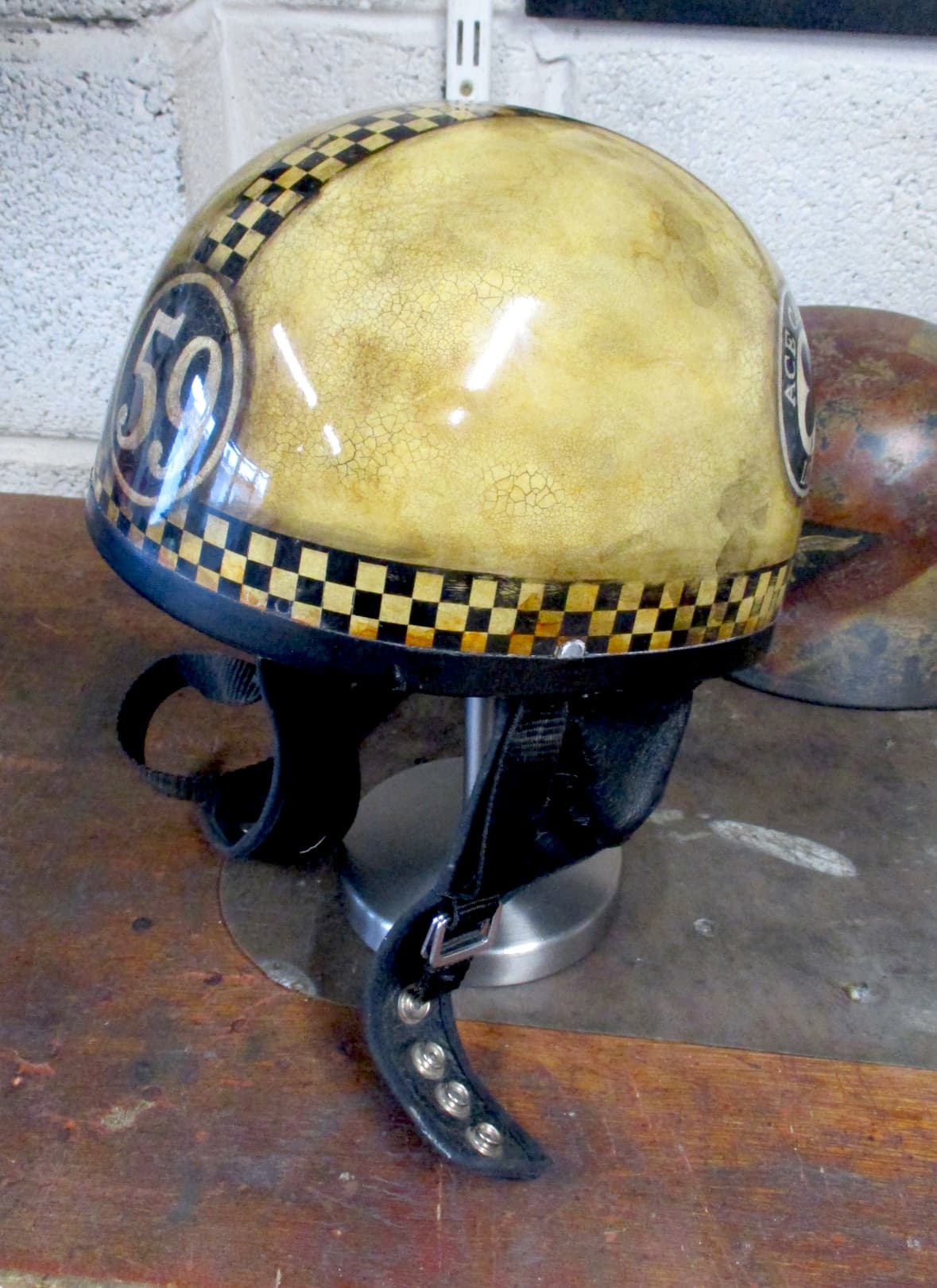

Can’t remember if I showed you this one (remember that NOS pudding helmet I bought?)
Just the job for your Triton and the North Circular :slightly_smiling_face:
Imagine having mechanical nous and artistic flair, must be a cross to bear? :laughing::laughing::laughing:
Nice job @Iron
