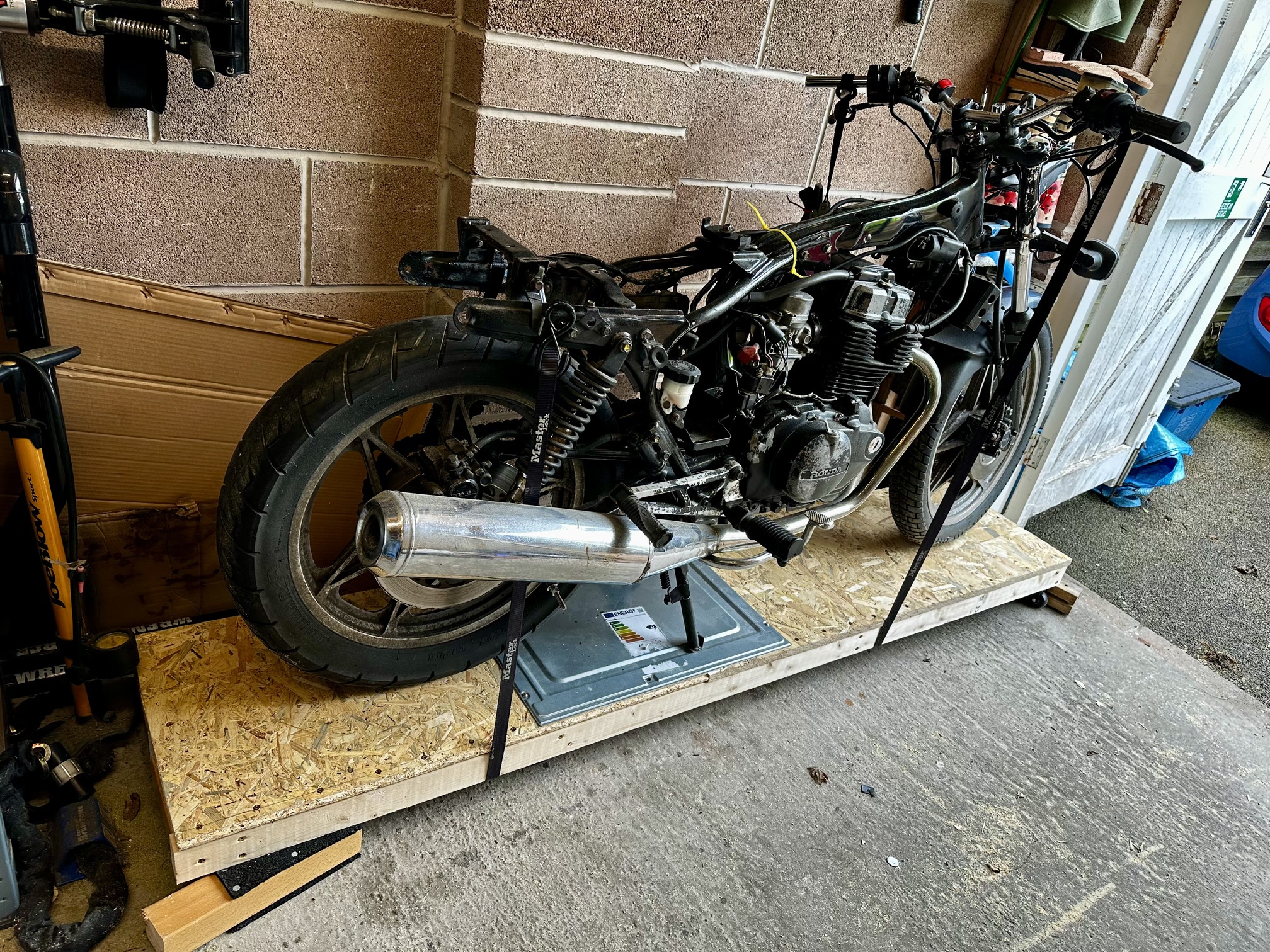

Ok… long time, no update! This is due to various health issues and minor home dramas… :face_with_raised_eyebrow: Some of you may also recall I sold on my TDM with an eye to purchasing a classic. Plans, being plans, are subject to change… so rather than being flotsam on life’s tides, I decided to try and take charge again.
So continuing the ratbike rebuild will become a focus for me as much as I can, and I decided I needed a mobile platform to raise the bike a bit AND to be able to move it in and out of the side of the garage (which being tiny, needs easy access through it)

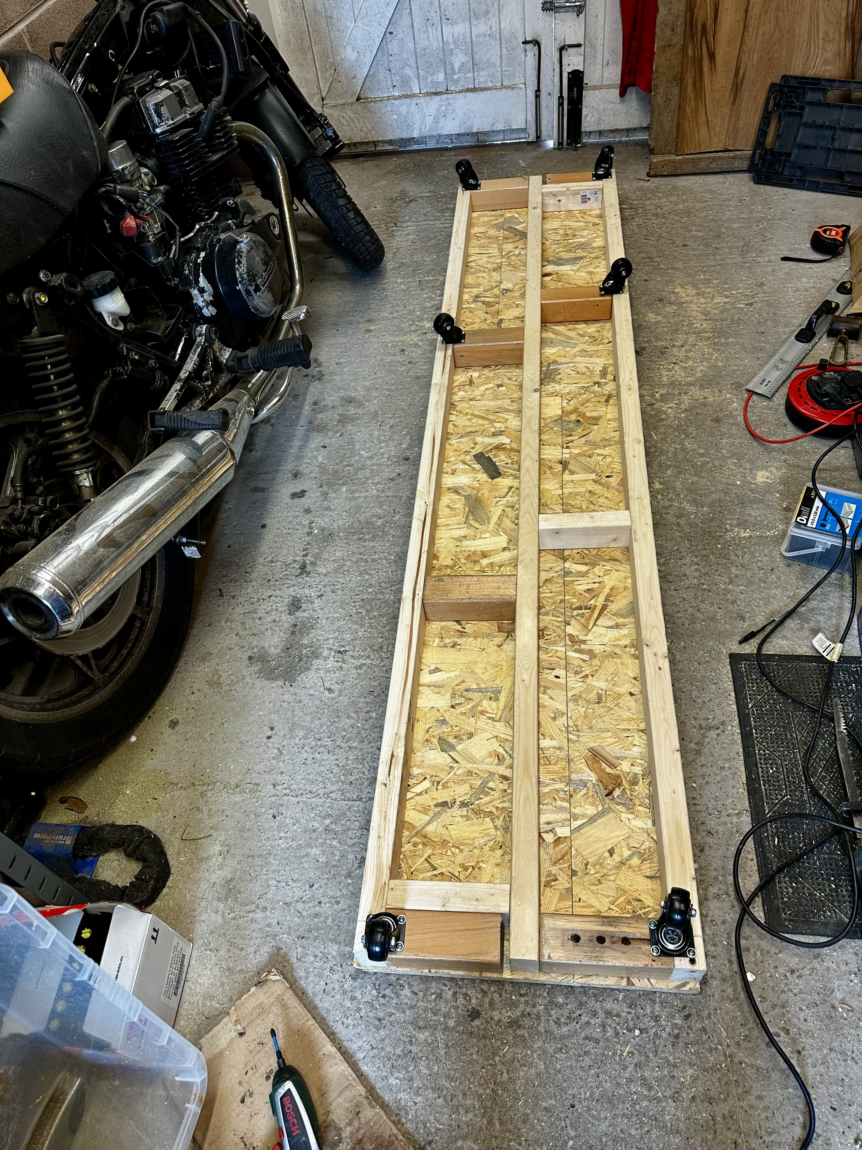

So I build a ladder style frame; hoof some loft board on it and some castors on the bottom. I chose 6 so I could position the middle pair to be around the centre stand region.

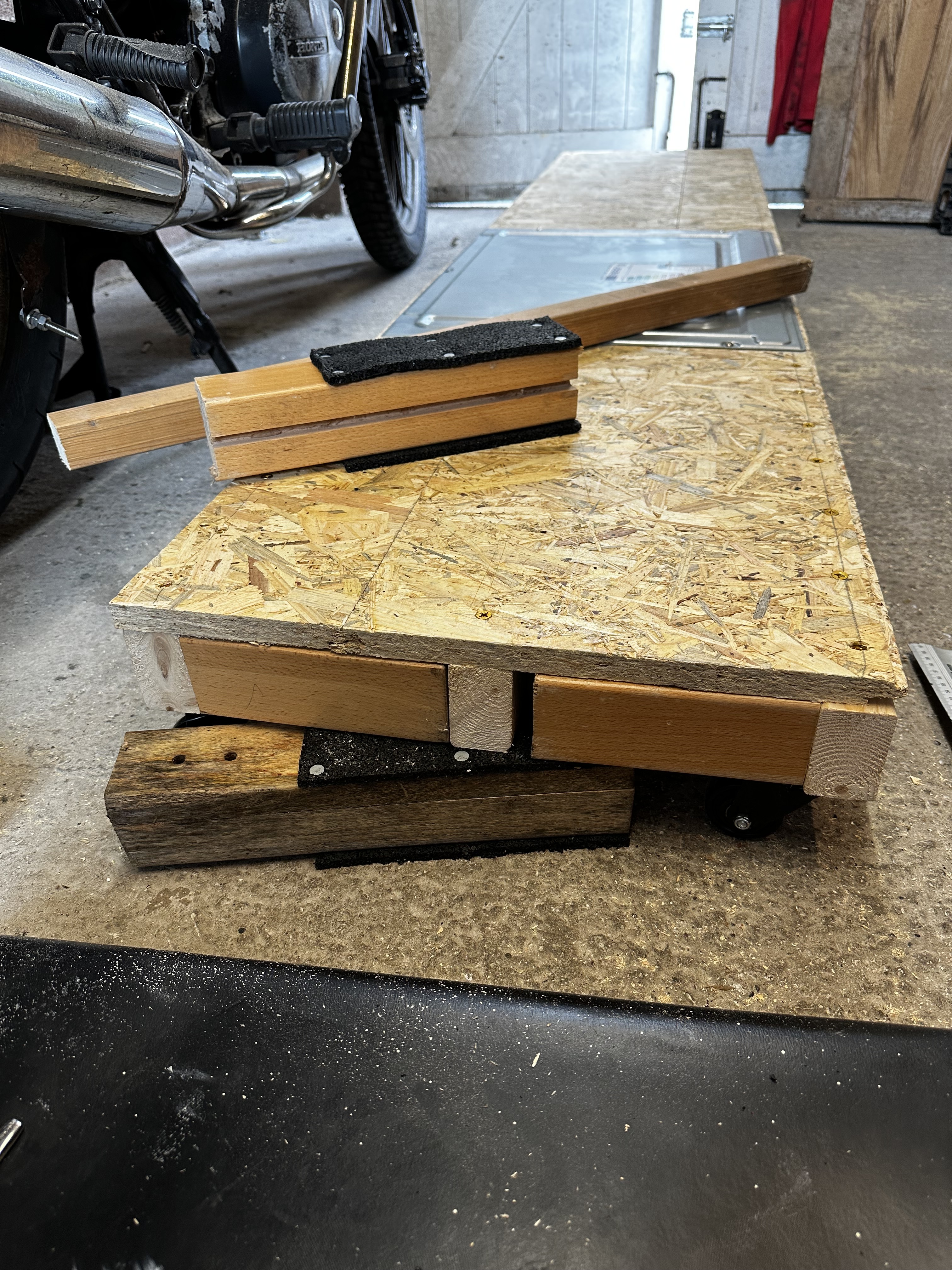

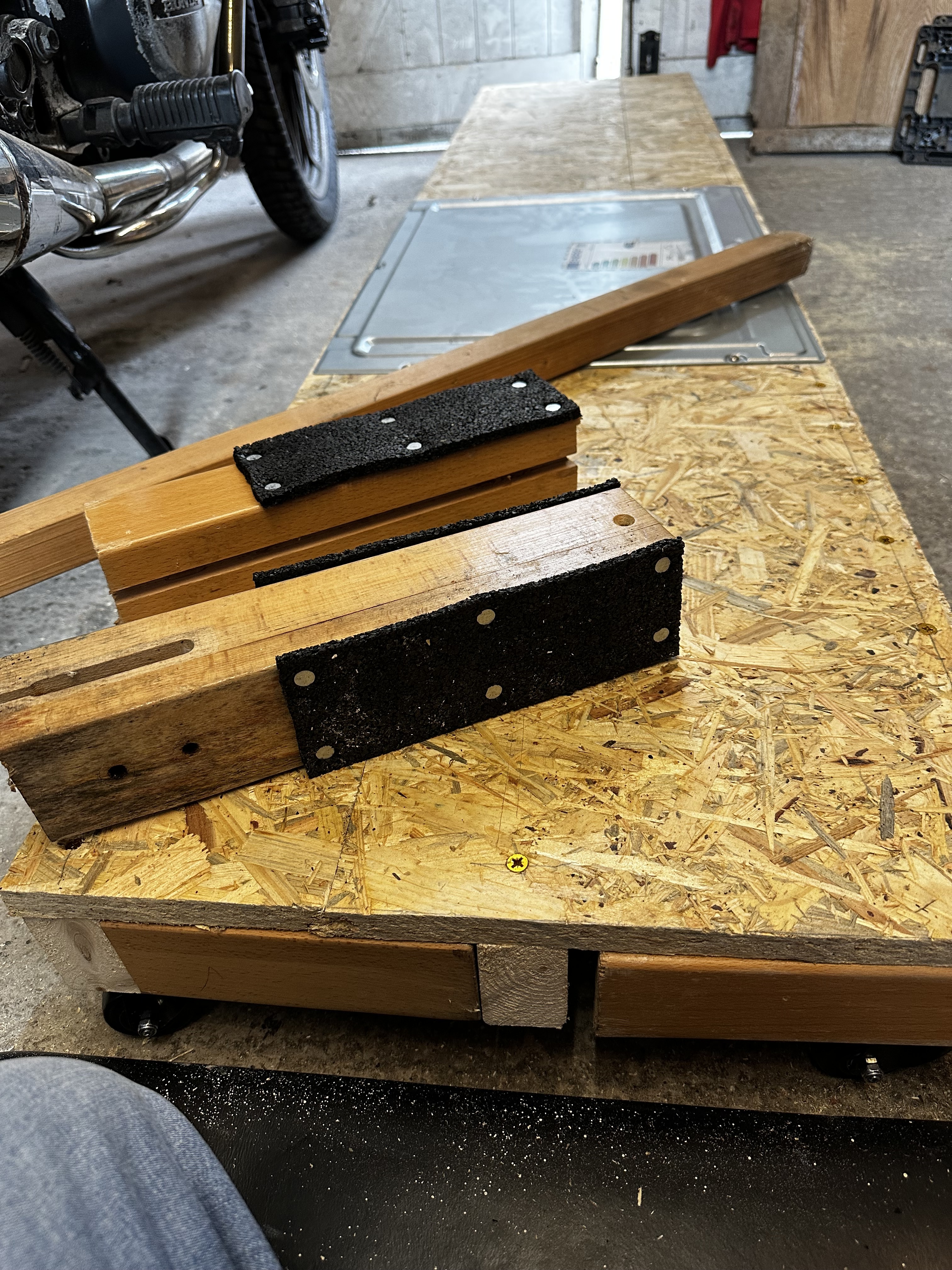

I strengthened the centre stand area with the back of an old washing machine… yes, I’m a hoarder! In my rush to finish the job, I haven’t made decent brakes for it yet. I use the length of 2x2 to lift the ends slightly and slide under the rubber edged chocks.

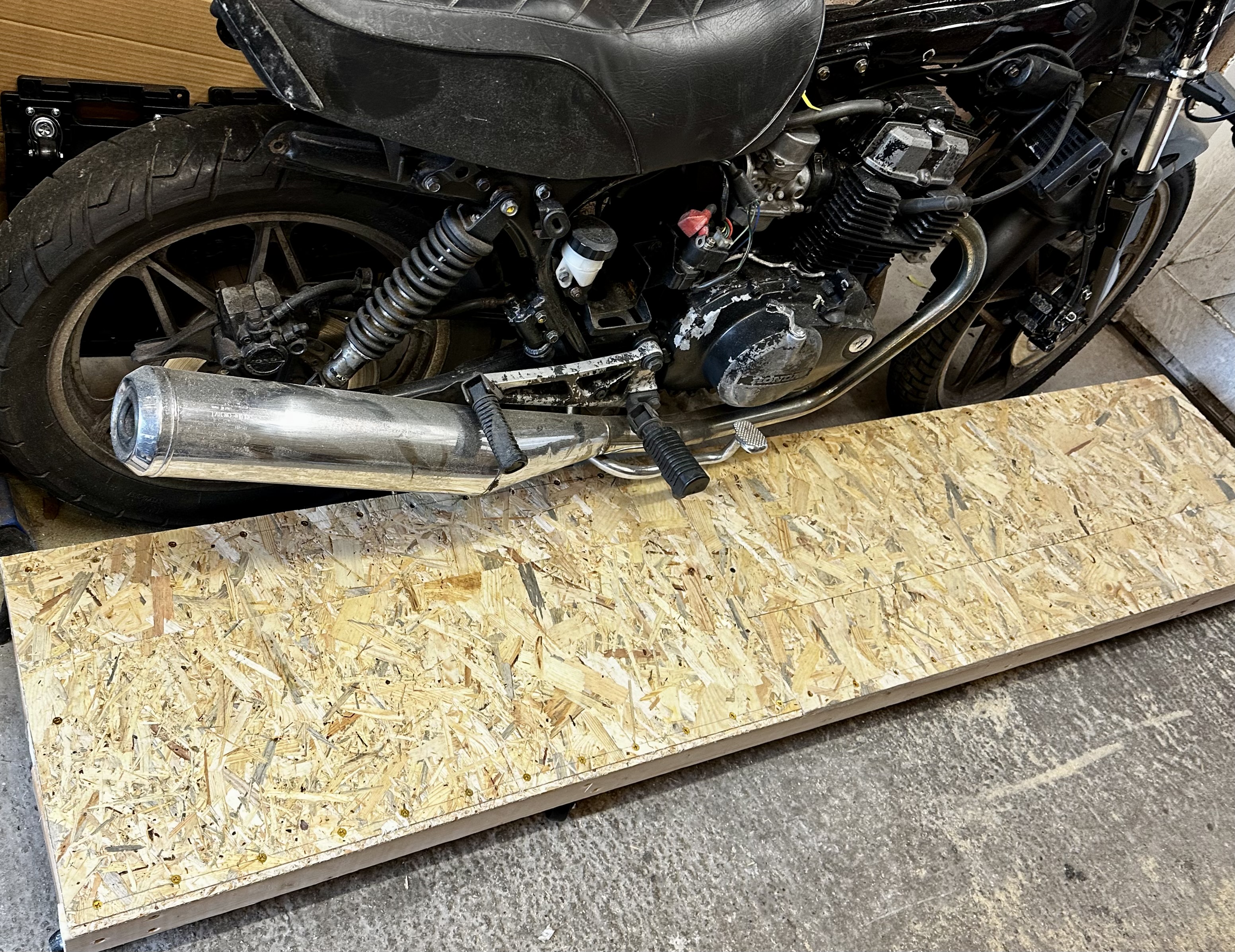

So putting the bike onto it was entertaining… not! But all I need is a simple ramp. I will, over time, knock up some brakes for it and get a wheel chock for the front… otherwise… TAH-DAH!
