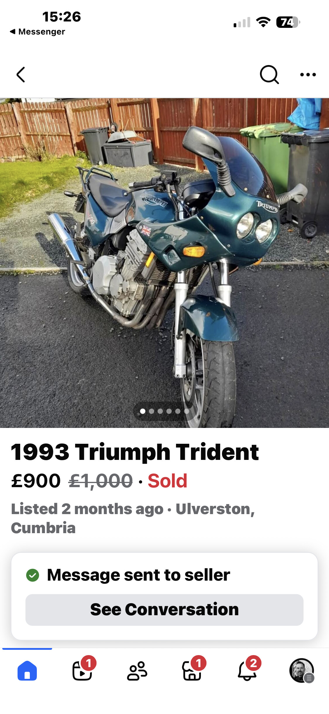

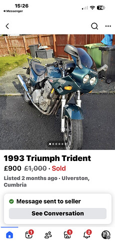

But here’s the guff…
Ahh, just gone on the market place and it’s shown as sold, they never let me know!
Back to the drawing board
That’s a bit poor form. Hope you get sorted soon :+1:
Oh dear! I now feel even worse about my failure to respond quickly as that looks like it would definitely be worth a closer inspection, especially at that price. It looks like an early Sprint, though it could be an riginal Trident with a Sprint fairing added by an/the owner. It appears remarkably original - original (or OEM replacement) front brake discs - now impossible to buy; original silencers, also NLA.
Actually, a second look at a magnified image suggests the fairing has been added later - the front decal is wrong and the ‘flag’ decal is wrong. I’m unsure about the mirrors but fairly sure the indicators arent original, though that’s no surprise, they do give up after a few years and are long since unobtainium. Overall, though, and at the price suggested, a good buy … assuming the motor’s as good as the cycle parts. Keep looking - they can be really rewarding to ride and own.
Don’t fret Adie, it went but they hadn’t responded to me anyway. They say the fairing was a sprint swap over, so they were not trying to pull the wool so to speak! :+1:
