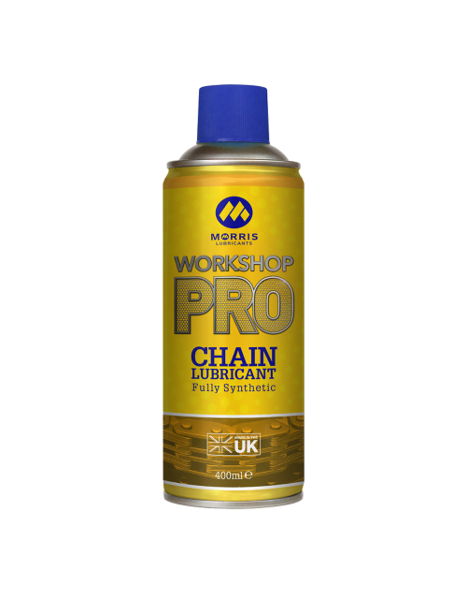

I can recommend Morris Workshop Pro Chain Lube too :ok_hand:
