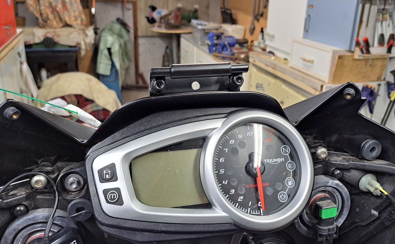

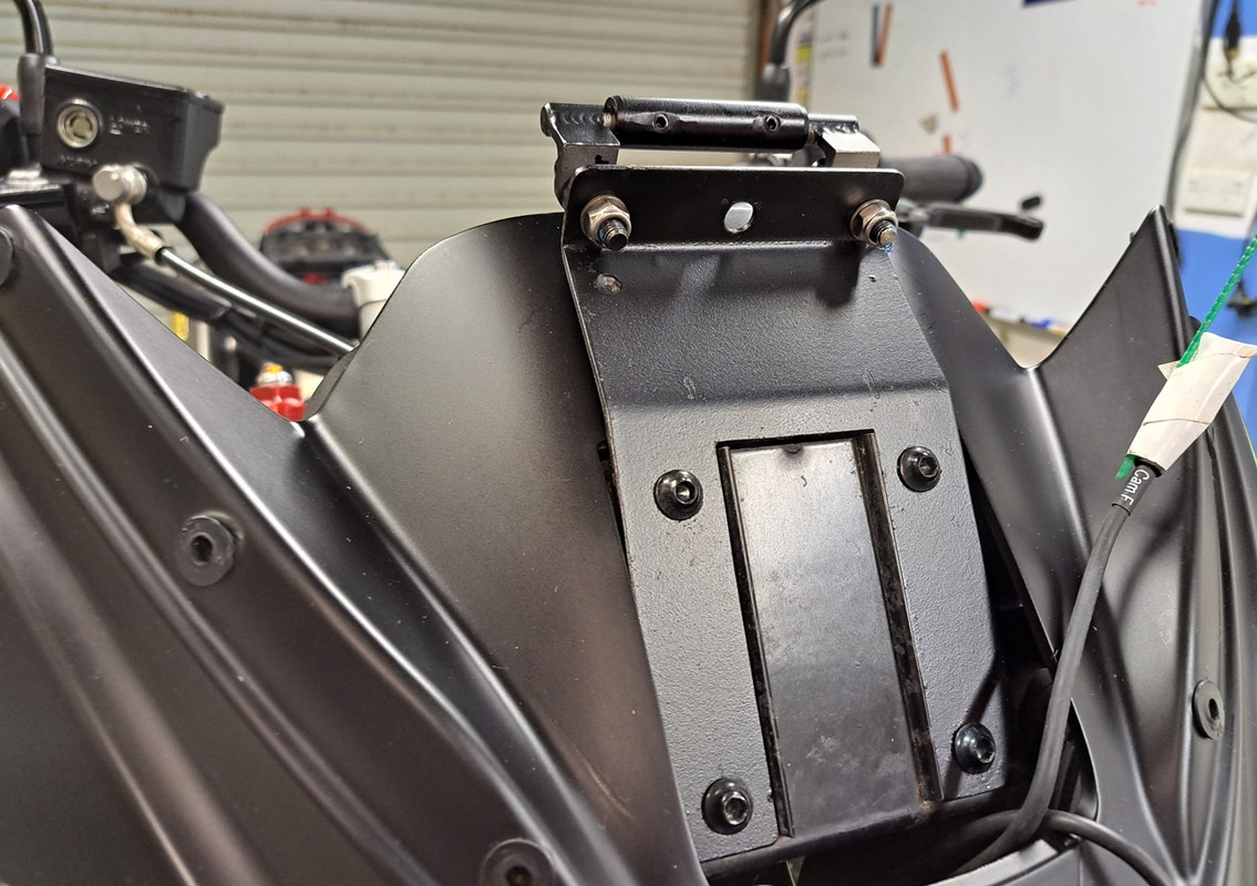

Firstly I had to remove my custom Garmin XT GPS and modify the mount to suit the Chigee crossbar mount. Which is an optional accessory.
After running the cables for the Front and Rear cameras, and GPS antenna, it was just a matter of running the power cable from the battery and the switch wire, which I’ve connected to the heated grips fuse temporarily. I’ll probably connect it to the Healtech Thunder Box, once I’ve completed the set up and testing.

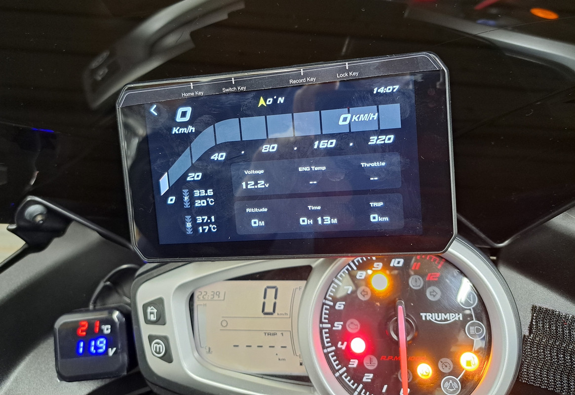

Home screen - after I’d paired the TPMS
Information screen - ignore the anti static strip which Ive left there till I learn the button functions

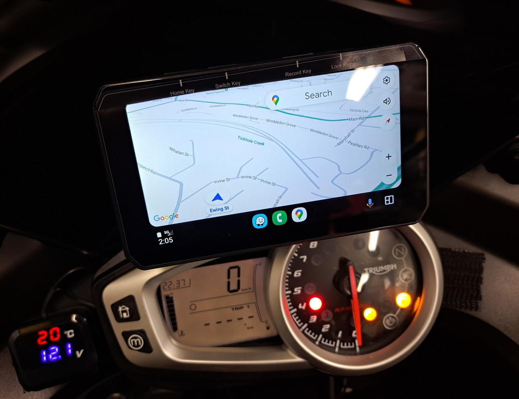

Android Auto screen, showing Google Maps.

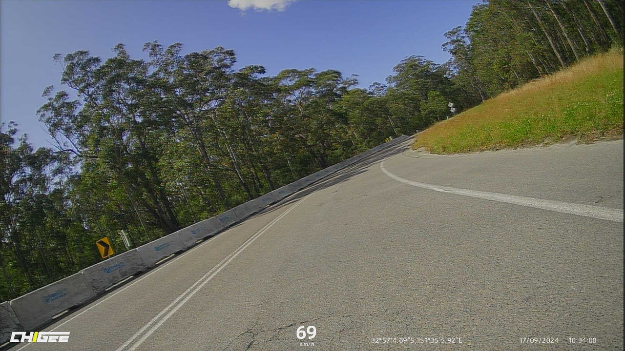

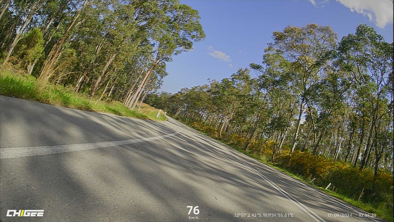

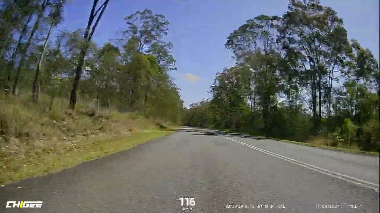

A few of pics from the dashcam from my test ride
Some raw video from the dashcam, Youtube seems to down grade it a bit.
