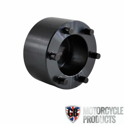

A correct sized socket is acceptable, but ideally you want one of these…
Probably the right one but your workshop manual should list the correct part number.

As usual the special tool is stupidly expensive (£18) for a one-off job but then again, I’ve been thinking about a forum toolkit library idea so maybe this could be the inaugural item on the virtual shelf.
@Col_C Some of those tools list the model. This one doesn’t. Is that because it’s a generic one-size-fits-all with exceptions for Tigers, Daytonas and Speed Triples?

I’m happy to buy the tool, I just want to make sure I order the right one.
I checked with the supplier of the tool on fleaBay, GB Motorcycle Products, who pointed me to this item:
They were quick to respond, polite and helpful.

It’s not a socket in the normal sense. Anyway, @Col_C shouted at me. ![]()
Which seems to imply Triumph have at least three different variants of stem cap. ![]()
A least four, in fact. Probably more.
