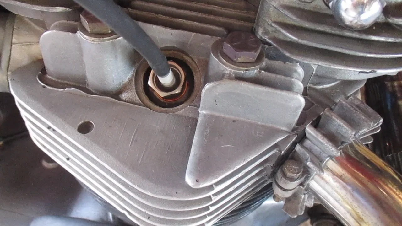

This is the little spark plug. There’s only one so each cylinder is tested individually. (Or you buy more kits). Make sure the correct diameter kit is ordered - bikes are normally 14mm.
It has a ceramic/plastic centre so it can be seen through.
Run the bike up as normal getting it warm so there’s no choke involved and it’s ticking over well.
Remove the normal sparkplug and thread in the little tester sparkplug. The head will be hot and the weenie tester sparkplug is a bit fiddly - you don’t want to thread the plugs, make sure they go in easily, no need for a spanner. Just nip up onto the copper washer.
Screw on the extension cable that came in the kit…
…and connect the cap onto the extension - it just pushes on.
Start the bike up and watch the flashes in the test sparkplug window. Orange is too rich, blue is too lean. The air mixture screw can be turned to watch the clour change. The aim is to move from orange and just into blue.
See how the window is dark then lights up blue around the core.
