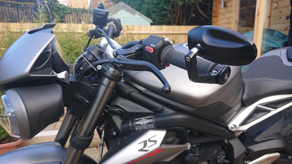

Probably me bing stupid but, how do you tighten up a loose mirror on. street Triple 765? The bar mounting is ok, it’s the actual mirror that’s loose.

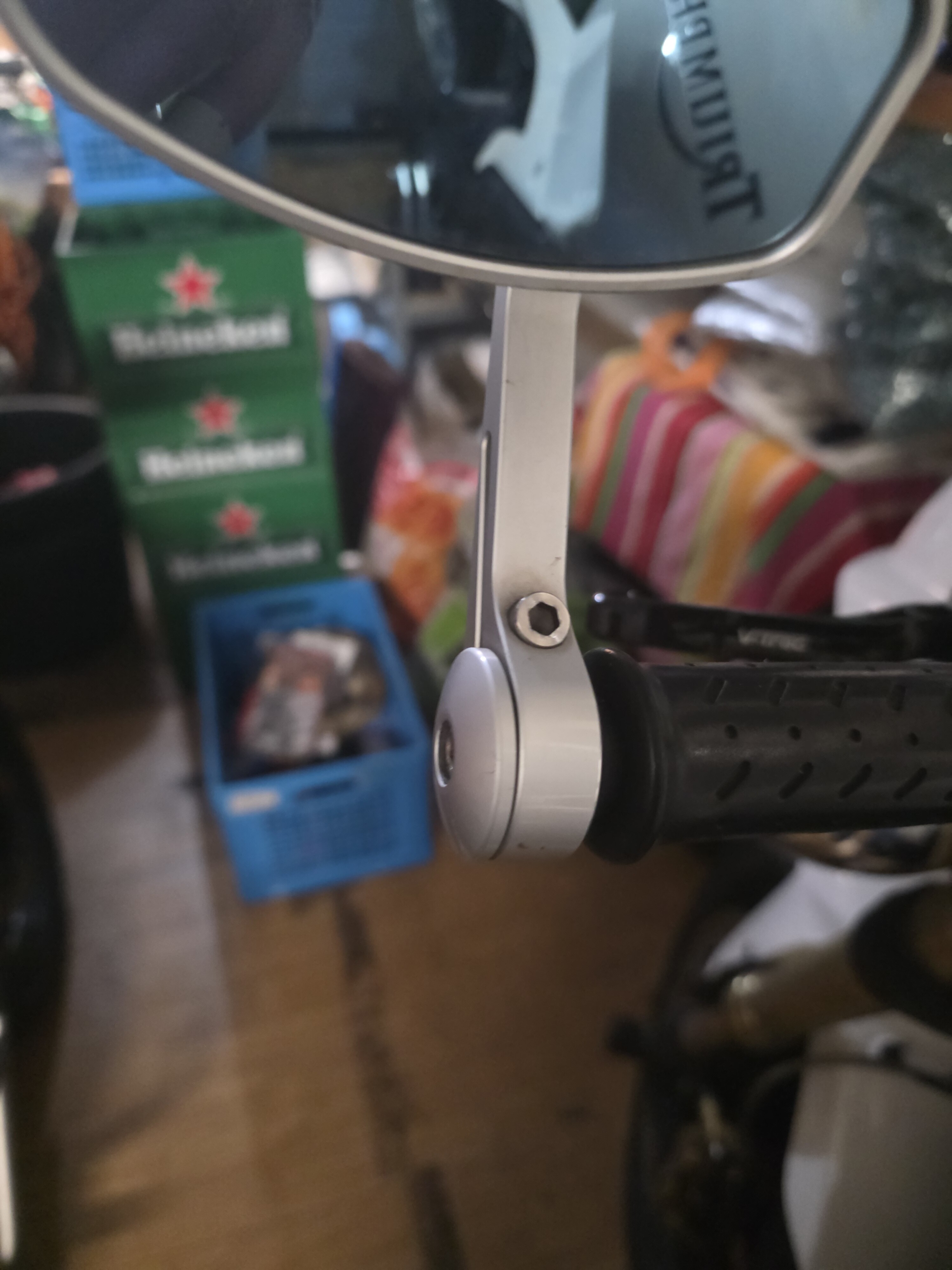

Isn’t there a hex screw on the bar-end clamp you can tighten?

Something like this?
No, it’s the mirror on the ball mount, not the fixing to the bar. Should’ve taken a pic.

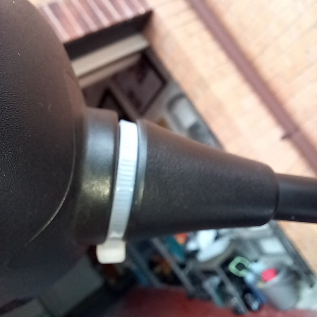

I had something like this on my Honda CB500X - the mirror head coming slightly loose at the top of the stem?
On that bike it couldn’t be tightened without taking out the mirror glass, so I used a zip-tie tightened at the junction of the mirror head and stem! It wasn’t all that visible and was intended as a temporary fix…. but was still there when I traded it in a few years later!
I eventually replaced this clear tie with a black one, but this is where I fixed the zip-tie - brutal, I know, but it worked…..
its not a problem in my eyes if it works….Good fix..

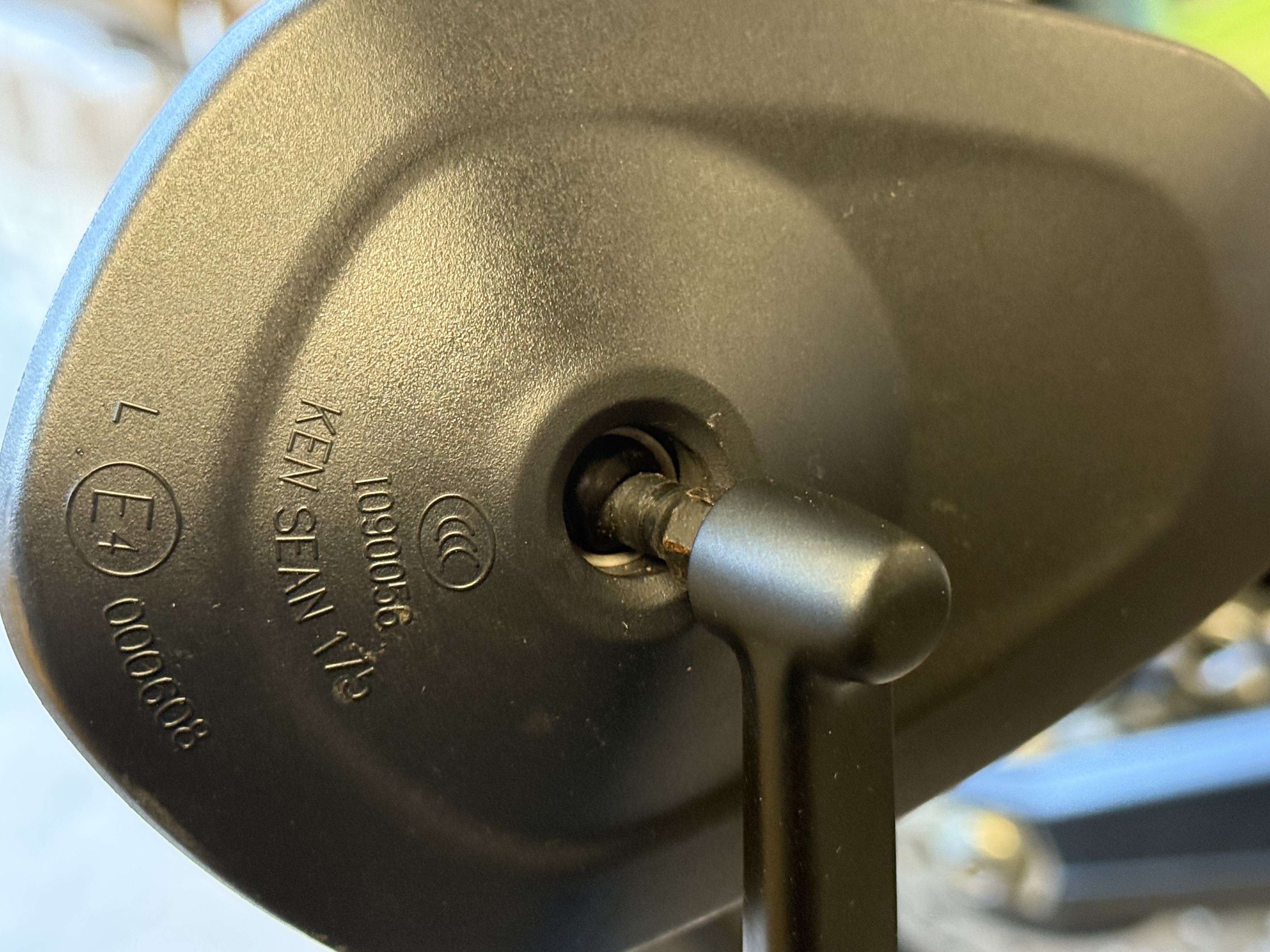

This is the bit that’s loose.
@Tigcraft of this parish popped rounds yesterday and suggested removing the mirror and using small piece of cement bag, for its hardy properties, to pack it out.
Nicely explained
I just know that if I tried that the mirror would crack when I levered it out! :zany_face:
