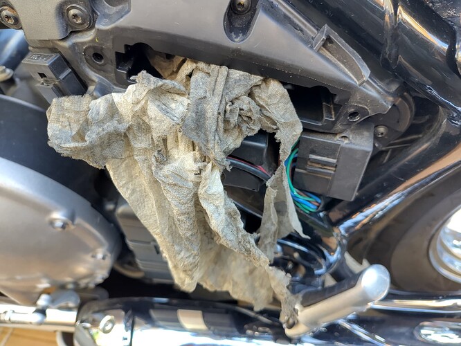

Anyway, below are photos of the spark plugs which I pulled after letting the engine cool; though as I said, it had been running mostly fine for the 5 minutes before getting home. The one with the masking tape around it is from the right cylinder and appears to have more soot around the insulator and side of the outer conductor. Presumably from unburnt fuel due to too high a fuel/air ratio or incomplete combustion due to weak/late spark?
When I replace the spark plugs I did notice that the cap on the right side wasn’t as ‘grippy’ so perhaps the connection isn’t great. Though using a torch and magnifying glass didn’t show anything different on the inside of that connector.
