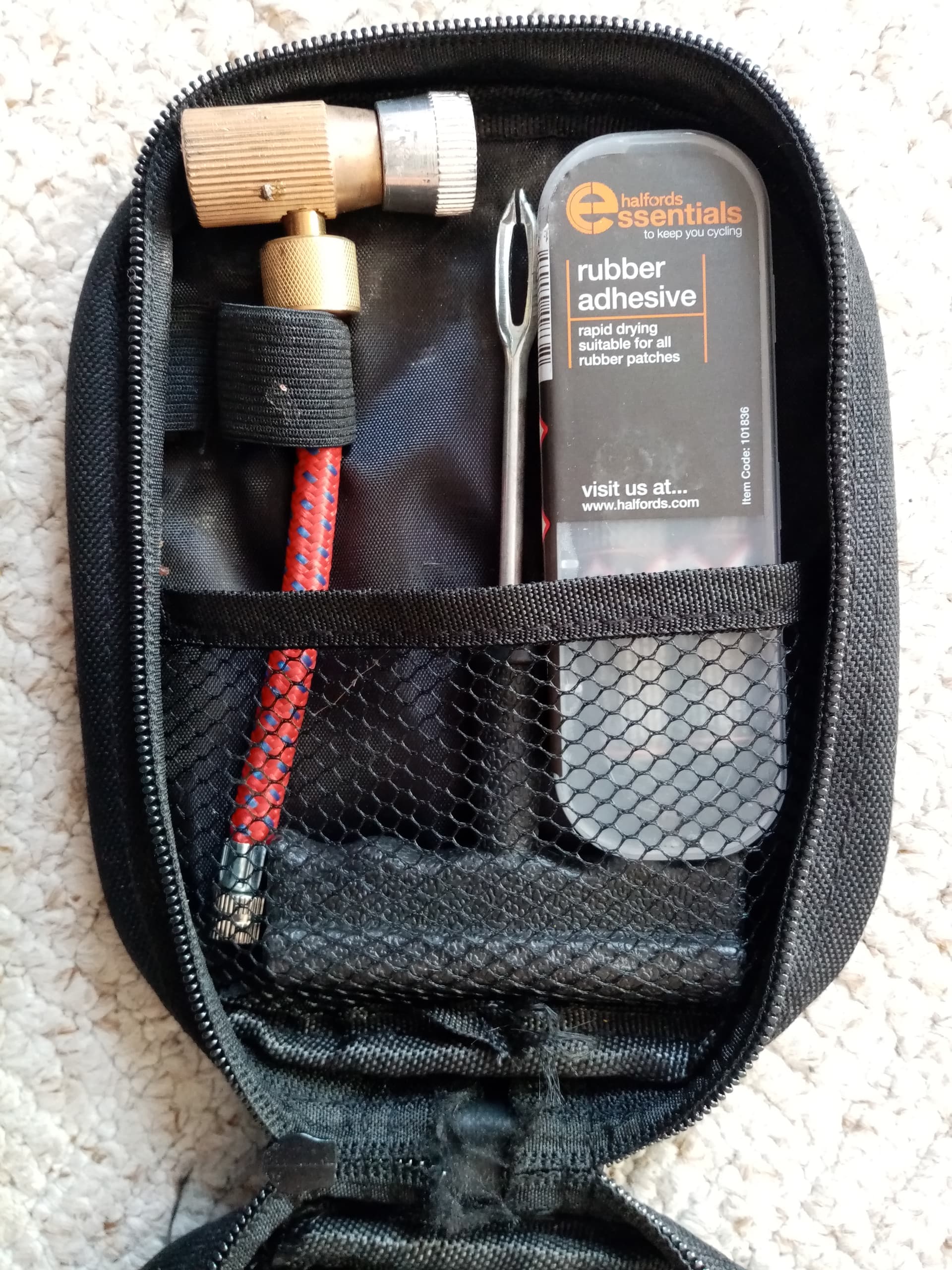

Aye this one, comes with everything you need, case is 8" x 5" like a pencil case, bloody brilliant
I even repaired a puncture on my NissanTerrano with it, my mates Busa and another mates suzuki Gladys.

They do work, my mates busa took four to take the tyre up to around 30lb. The kit comes with an attachment like you used to get with a push bike pump to attach to the valve, then you just screw the cannisters on one at a time until you get a decent amount in, it took six cannisters to inflate my terrano enough to drive home and blow it up properly, the mushrooms saw out the life of the tyres.
