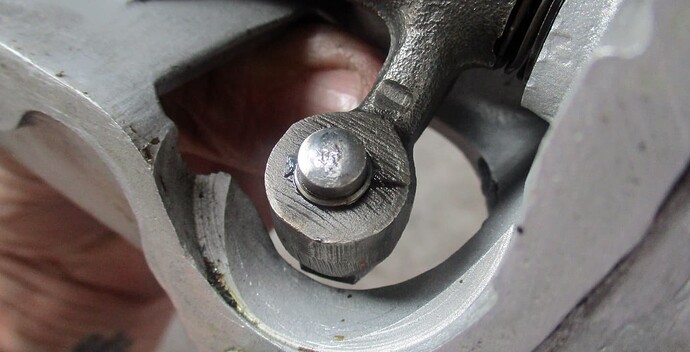

Carefully tap out the rocker spindle with a toffee hammer. See, now I’m glad I went in for a look. The o rings look flat and the previous knob got here and liberally applied wellseal to the end of the spindles to alleviate oil leaks rather than using a thrupenny o ring…
The tappet adjusters look to be a bit worn and pitted

The tappet adjusters are quite expensive so I’ve had a go at cleaning them up. If I need new ones then I’ll get some as they are easily replaced if need be.
