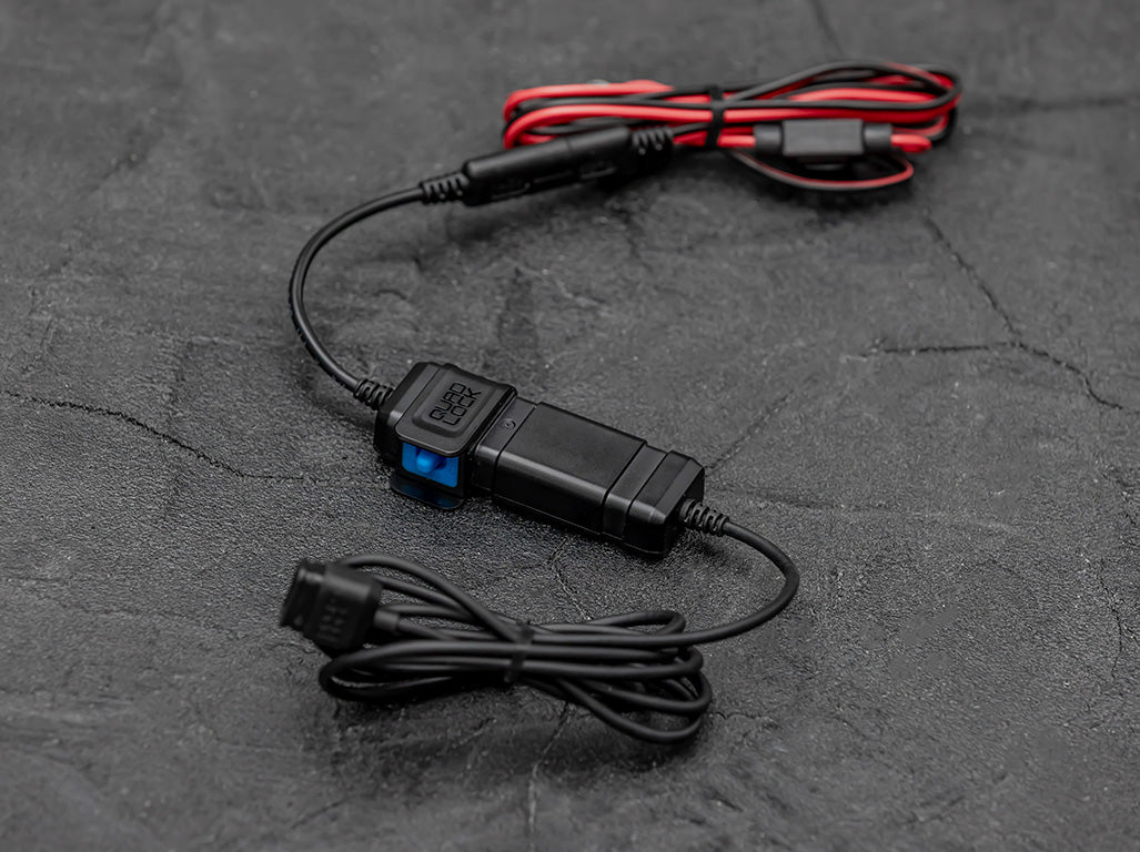

I have used several combos but the ones I would personally recommend are Quadlock (attached the battery under the seat and the USB end simply routed under the tank and mounted on the handlebars using a cable tie). The other is a bit more permanent a requires a hole drilled in the fairing (see my Sprint GT 1050 below).

I was looking at where you have placed the usb, initially, on the bike and I guess in the faring, but did also wonder how to wire it in to a switched live…
I guess one answer is indeed an actual socket that’s switched! Good call!
If you do go that route, you need to make sure the switch is on the 12V side, not the 5V side, as the latter would mean the 12V-to-5V converter is permanently running (I measured my TomTom mount as draining about 1Ah of battery capacity every week). With my recent apparent weak battery problems, I’m rethinking that and am going to find a switched live on the wiring loom to tap into.
