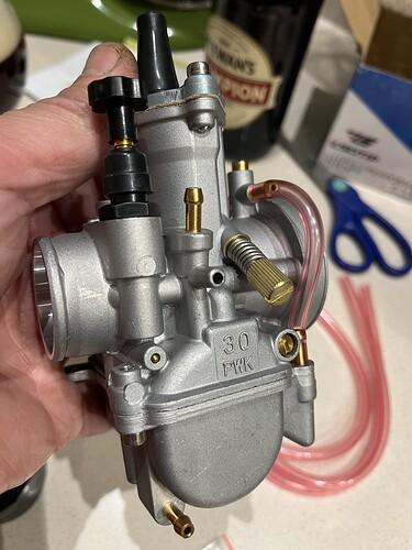

Made a new gadget!!
Stripped crankcase and built up but before I finish engine I wanted to find a away of testing what I’d done…
Whats happening there then?
Looks a bit ‘steam punk’ I know. It’s to test crank pressure leaks on a two stroke. Tests new seals and any crank case cracks
