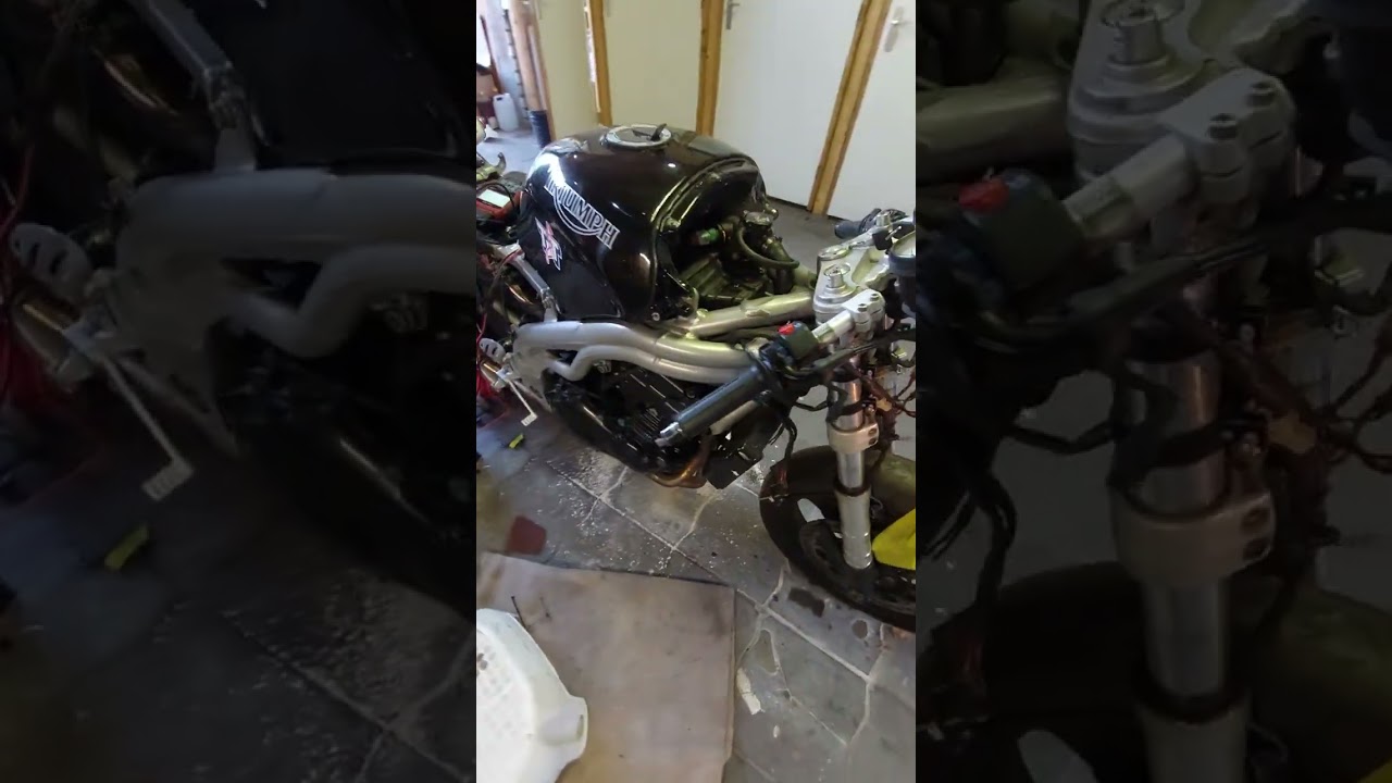

It runs ok but with a lot of noise.
Here’s a youtube link
Does not sound like a bigend to me.

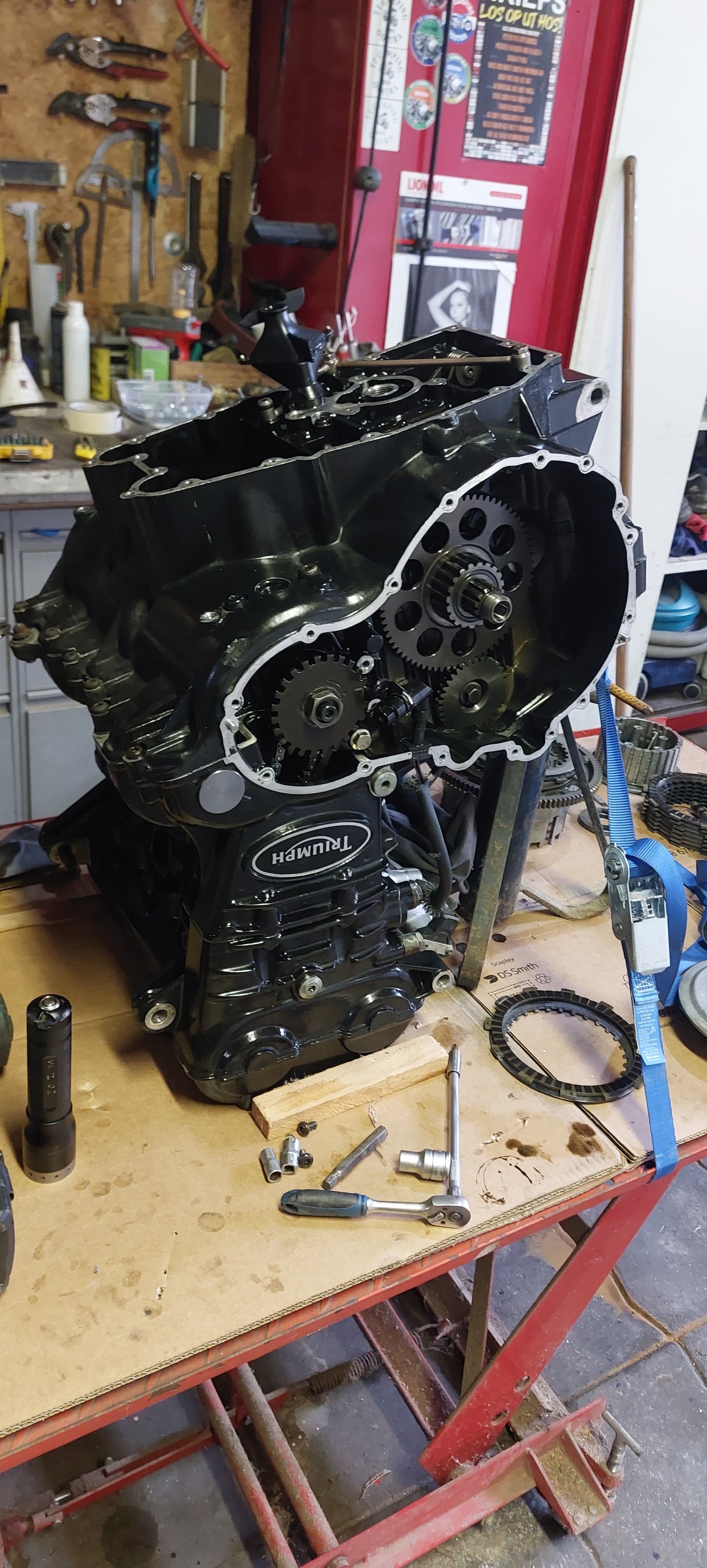

To much space on the gudgeon pin and the rod.
Will be searching for a new set.
Greetings.
Hello,
Its been a while.
Found 3 piston and rods.
Took the engine appart again.
There was another rod that had some space .
I have changed 2 piston rods.
Put it back together, and its running good again.

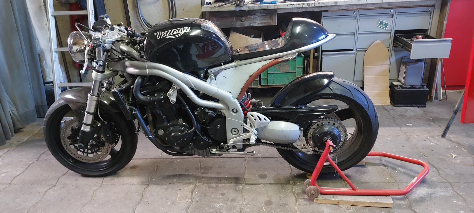

Made some changes to the subframe.
Does anyone know where the vacuumline from the fuelregulator comes from?
