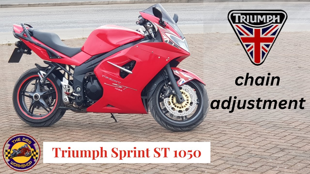

Just about to go and figure this out. Not sure what the process is for the Sprint. Any thoughts, ideas of advice?
Edit: Found a useful video.
It seems I need a C spanner and don’t have one to fit, so I’m looking at this one on Amazon. Does anyone know if the same tool fits all years? The ad doesn’t make a distinction between the ST and GT, either. Are they the same?
After all this I may need a new chain, which will be another set of posts. The one on there now is suspiciously slack.
