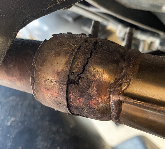

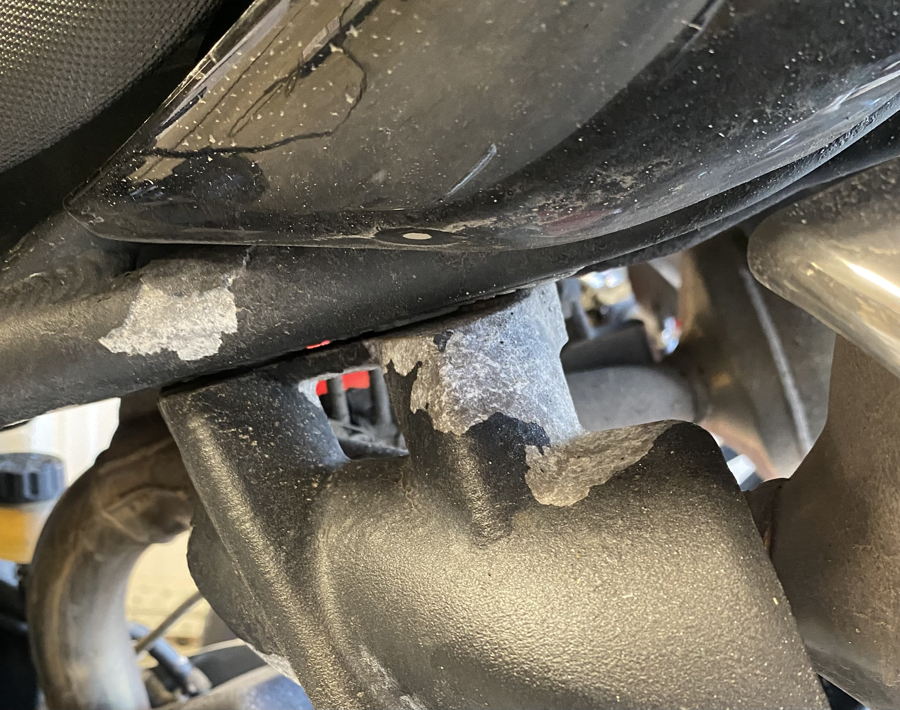

I’ve had my Street Triple for nearly 10 years. For some of those years it didn’t have a garage to live in and for a time it was with me in the depths of Cornwall, where the sea air is refreshing for the humans but not so much for the machinery.
Although I’ve had it serviced regularly and it’s usually kept pretty clean and tidy, the wear and tear is starting to show.
You can see from the pictures how a bit of TLC wouldn’t go amiss. Not shown are the chrome headlights, which have some light pitting. I know there’s some pitting on the forks as well. So far the new seal is holding uo but it may go again. The bike does need a wash at the moment so ignore any general grubbiness.
This is just the visual wear and tear. After 15 years and about 35,000 miles I’m sure there are some internal parts that could also do with a bit of an overhaul. Unless there’s a good reason I would prefer not to pull the engine and gearbox apart!
I’d like to bring the bike up to something approaching it’s original condition. I’ve got an internet full of useful stuff and a forum here with an impressive collective knowledge of all things bike. What I don’t have is any practial experience of a job this big. But I do have a large garage and lots of tools! It doesn’t matter if the bike is off the road for some months, so I have time, as well.
My initial thoughts are along the lines of, how far does the bike eed stripping down to do the job thoroughly, what can be restored and what will need replacing, will the frame need to be bare for recoating etc.
I’m very interested to hear from people who have wielded a spanner or two in their time as to what I’m getting myself in to, what problems I’m likely to encounter, and what I should be aware of before starting.

I’ve been going backwards and forwards in my mind for ages about the frame. Sometimes I think about just fixing up the corroded bit but then I start worrying it will look like a patch-up. Then I start casting my eye over the rest of the bike (see pics) and can’t help but notice it really would benefit from a serious overhaul.
