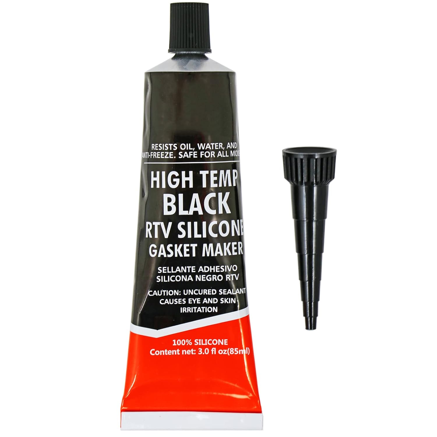

I use this when new joints are a bit loose. It dries like rubber and seals T140 push in exhausts and joints to silencers.
