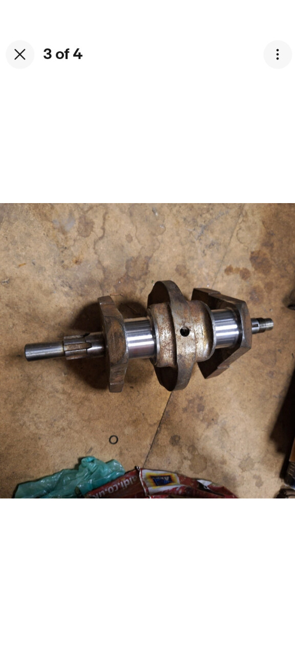

I have a Harris that uses the TSS crankshaft machined down (tragically) to suit standard T140 rods.
This is my spare crankshaft
It’s a new old stock TSS that’s been machined. San’s the flywheel of course. If I ever use it I’ll have to swop it as there is zero chance of finding another TSS flywheel.:roll_eyes:
