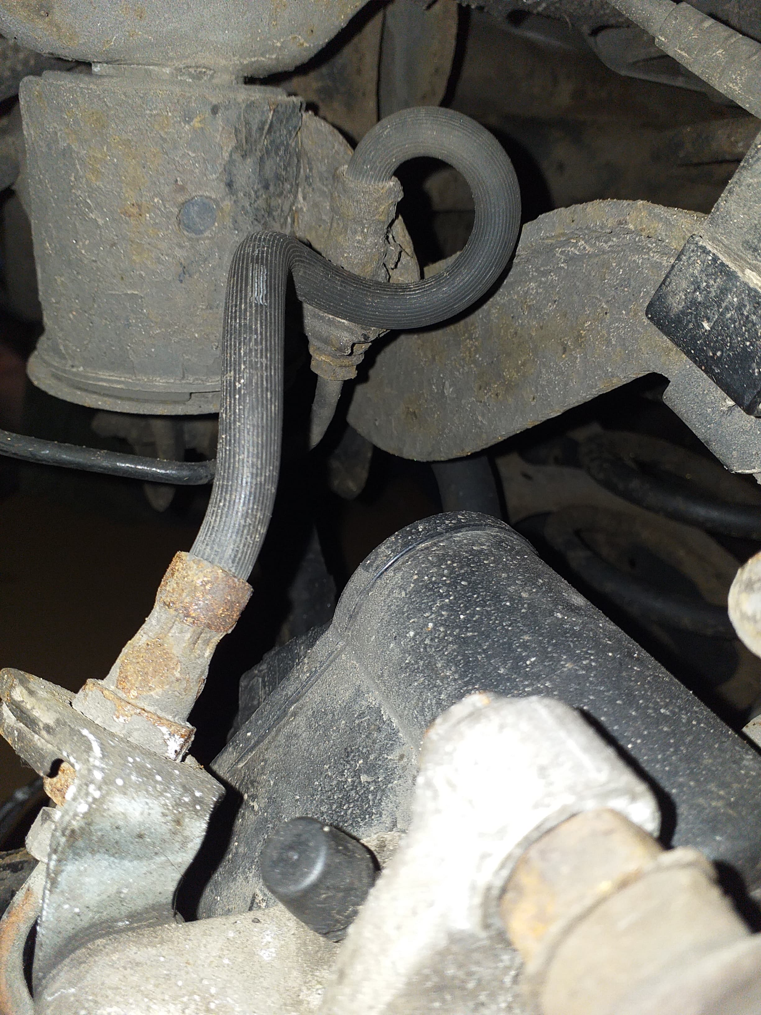

Failed mot on worn brake pads. For speed l told garage to replace them. Rang me to say couldn’t do it as a caliper piston was seized. Fetched it back, braking was terrible (see photo
) That caliper was new last October. Supplier won’t replace without viewing it, which would mean open hydraulic line for several days. In the meantime reversed up to container to dump some stuff, braked, nothing happened until BUMP the container stopped me. Busted rear light, one coming from Ebay. Ever feel like you’ve shot a robin? ![]()

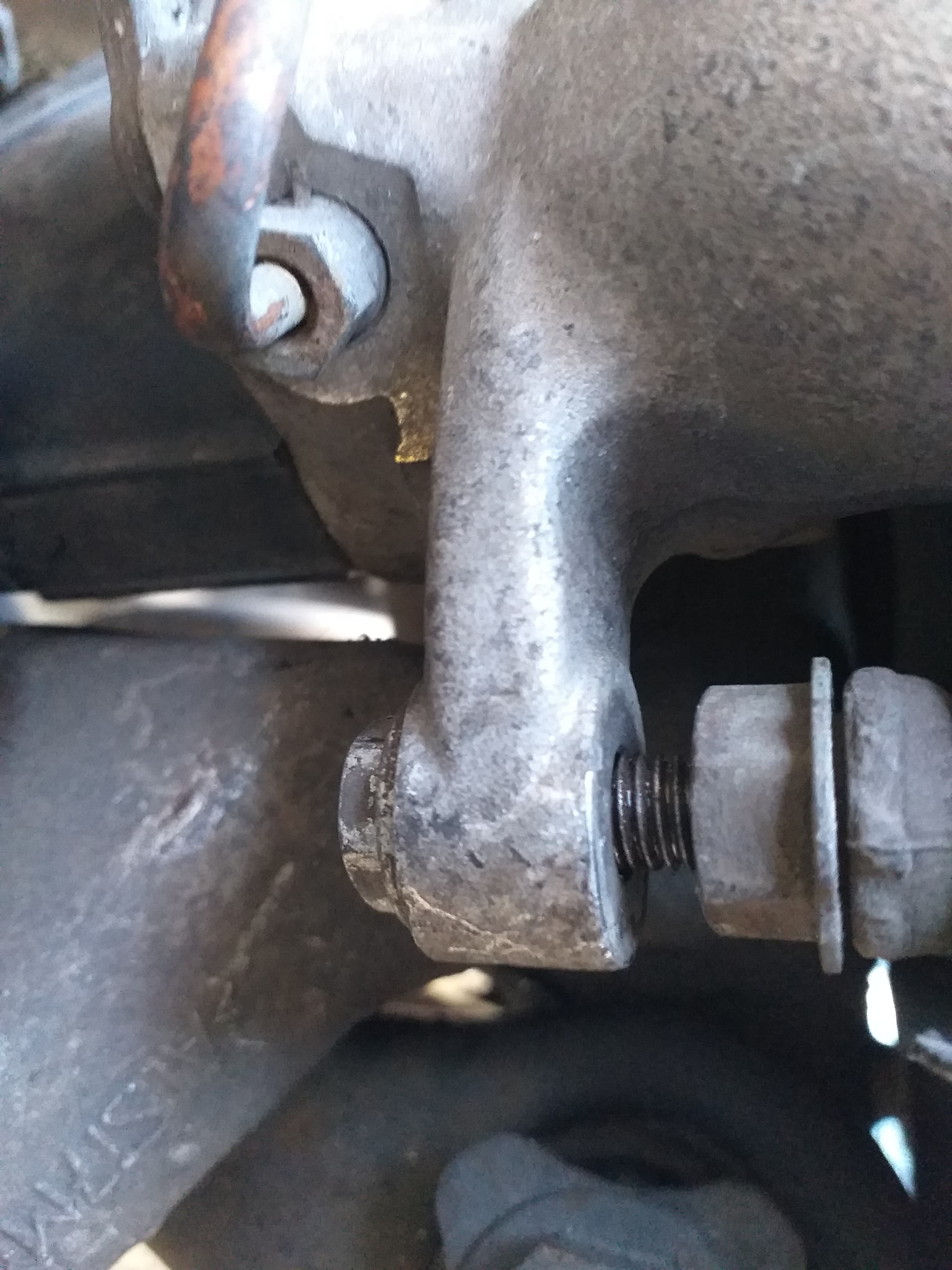

This is how a professional leaves your caliper slide pin…

What can I say…. There’s mechanics……. then there’s mechanics!

Well, coming back to the professional repair on my car-as you are aware the caliper slide pin bolts were loose, causing the brakes to operate a bit randomly. Found 4 faults with our VAG diagnostics, so clearly they’d not correctly set in service mode, or done basic settings afterwards. This also matters because you can’t retract the piston if the brake motor hasn’t been rewound, so you get symptoms very much like a seized caliper piston…you know where this is going. Once we rewound the motor we pushed the piston back by hand
