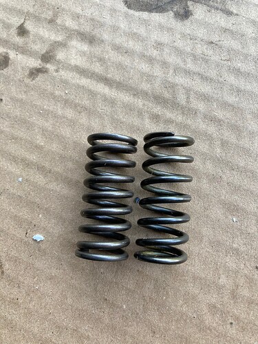

I did the error to put the “reinforced” spring supplied with the EBC disc kit.

And the bl…dy reinforced springs vs genuine one

And for the ones who buy EBC clutch disc kits, do not mount the supplied springs. Keep the genuine ones.
It’s a non sense to provide heavier springs, knowing that the genuine ones are strong enough to avoid any clutch slip.
