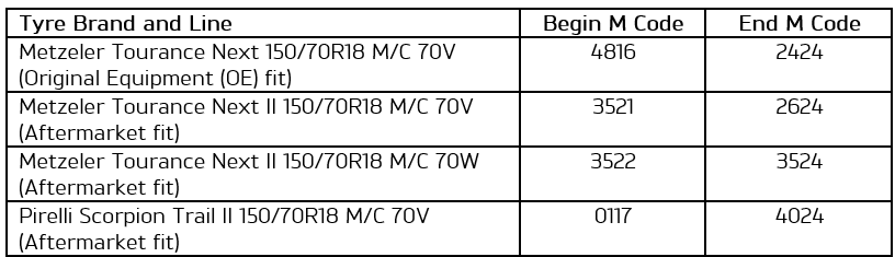

In addition to recalling the Metzeler Tourance Next 150/70R18 M/C 70V, Pirelli Metzeler are also preparing to recall a further 3 tyre products as listed below. These additional 3 tyre brands were never fitted by Triumph to the Tiger 1200 range, but we include details in case you have purchased any as a replacement. Triumph have not tested, approved or recommended either of the Next II tyres or the Pirelli Scorpion Trail tyre listed below:
588fdff2-ab97-ef11-8a68-6045bdf1f158
The manufacturing “M” code is located on the tyre sidewall (E.g. 4816 = week 48 of 2016).
Pirelli Metzeler provide the following owner advice:
Owners should check the condition of the rear tyre prior to riding with caution for the repair. Owners should also ensure the tyre pressure is set to 2.9 bar (290 kpa/42 lb/in²) prior to riding and the motorcycle should not be ridden with any additional load (luggage or passenger), and to keep the speed limited to the minimum allowed- applicable speed. Riders should also limit their speed to the minimum applicable for safe riding. If an owner finds any signs of tread separation or cracking in the base of the treads, the owner should not ride but instead arrange transportation of the bike.
