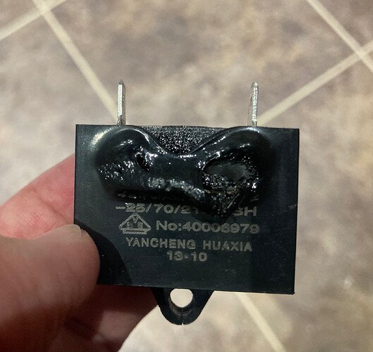

Fashioning a headset spanner into a thin (3mm) headset spanner on my bench grinder, and the power dies along with a hot, greasy smell (yes Mrs… I was at it for far too long)… pulled it apart to find the capacitor burnt out… but it’s burnt through the numbers, so I can’t find what values it is… bugger! For the want of a nail, the war was lost!!!

Ok… researching this, I think it’s a CBB61 2.5uF. 450v ac
So onto eBay… U.K. supplier … £3:15 delivered!
