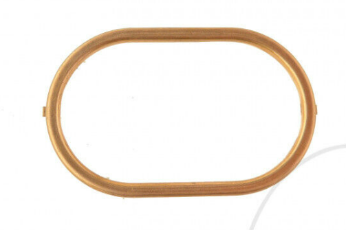

Out of interest, here is an image of the seals.
Notice the tags on each side. Might it be relevant whether these are on the bottom face (against the engine surface) or on the top surface (manifold face)?
Either way they need to fold in order for the seal to fit…or are they just manufacturing lugs that should have been sanded off?
Those are the tabs I was talking about, they are just to hold the gasket in place while fitting the headers. Orientation wont matter. If its blowing by the seal I reckon you have an issue with the alignment of the headers as @Col_C said. Doubling up the gaskets may work as a quick bodge fix.

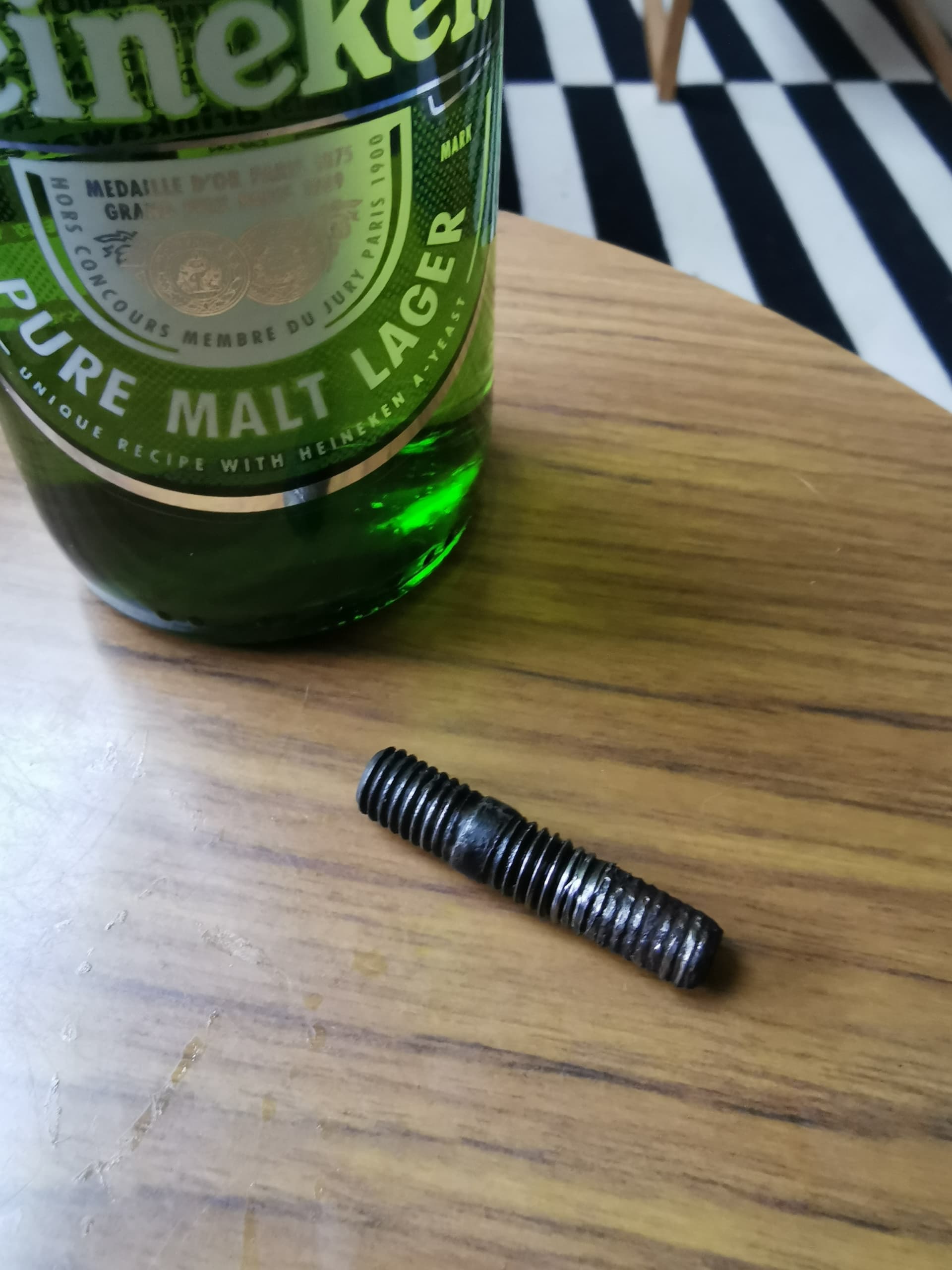

Old stud

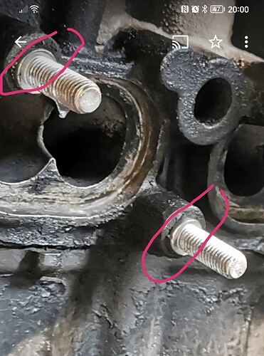

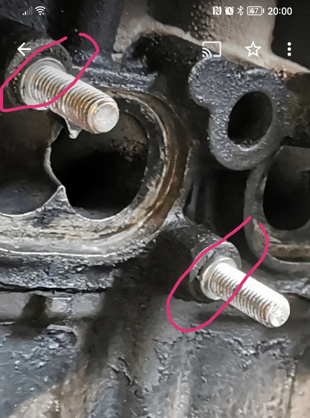

Close up of new studs
The new ones, bought from Fowler’s…have a shoulder on them…FFS…
They’re the same as mine, and in theory a better design as it gives a positive stop when fitting the studs. It might not be a problem as your originals had a plain unthreaded section too. But to check try feeling with feeler gauges whether there is still space between the stud shoulder and the backs of the header lugs.
There is, it’s visable!
I think, basically…I got/purchased the “wrong” studs…
What I can’t not fathom…is I would have bought them from Fowler’s/WOT…but, when I search the pages on there…I can’t see these studs! So where/how did I bloomin order them in the first place!?
Anyway, new set ordered with no shoulder this time!
