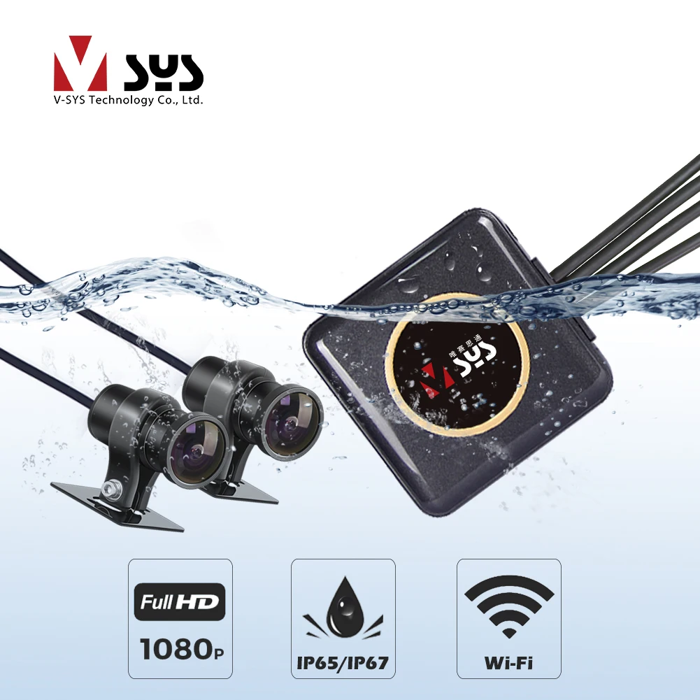

Have a look at the SYS stuff on AliExpress. I bought mine about 4 years ago and it’s been faultless and for the money it’s excellent. Build quality might not be up to stuff like the Inovv but it’s a lot cheaper ( I had an early Inovv that stopped working after a software update so they’re not for me anymore)
Just found this amazing item on AliExpress. Check it out!
£104.39 25%OFF | SYS VSYS Full Body Waterproof Motorcycle Camera Recorder P6FL Q6L WiFi Dual 1080P Full HD Motorcycle DVR Dash Cam Black GPS Box
