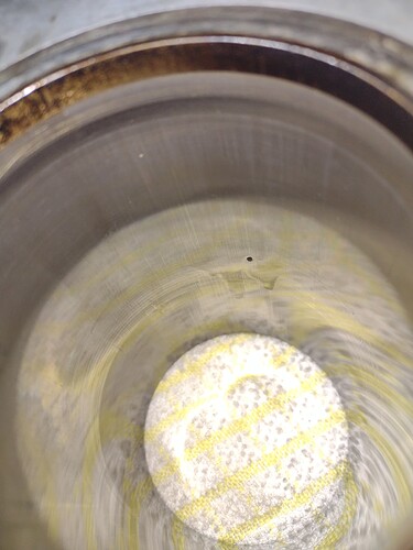

Dont know what to do next, does the last pick show to large a ring gap ( sorry thought pic was better,gap is around 3mm when squeezed in. The compression figures were obtained from a hot engine at “full throttle”.
Bore looks clean.Sending off today for bore measuring tool.
The black dot on the bore is just a spec of dirt.

The ring gaps are measured with the rings off of the piston and pushed down the barrels to where they would be at around TDC and square to the bore. Do this by pushing the ring down with the piston upside down. Or just measure it down about 50mm all the way round. Then measure the gap - it should be in the specification section of your manual. You cannot check the gap with them still on the piston. 3mm is miles too big - well about 2.5mm too big.
The bores are really nice, no discolouration, no scoring, no pitting. The pistons look good too.

The bores are great and pistons clean.
I will now take it to the engineer to have the bores measured, its £30.00 for a tool and I dont think the shop would charge much more. Then they can hone or rebore as required, and I know its good.
Worried about them not being round. Thanks.

So just a quick update, Went to the machine shop. The barrels are oval front to back, and enlarged bottom to top. The pistons are toast too. So its a re-bore then. Just going to stick to 750cc cos the head has been skimmed previously. Thanks for the advice. Any opinions on IMD Pistons?
