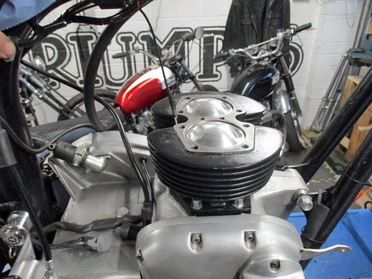

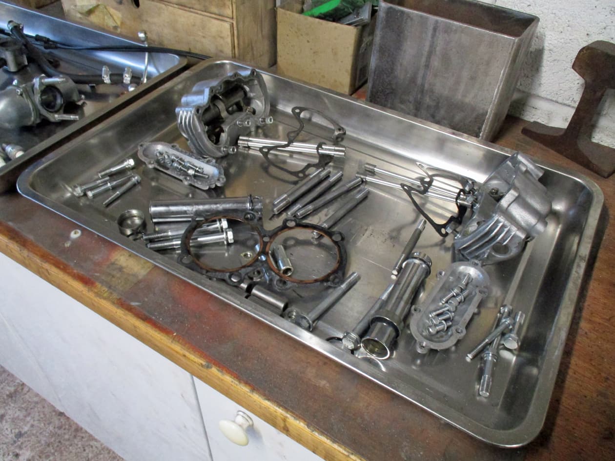

As I had the carbs off, I thought I’d just have a look a bit deeper so off with it’s head.

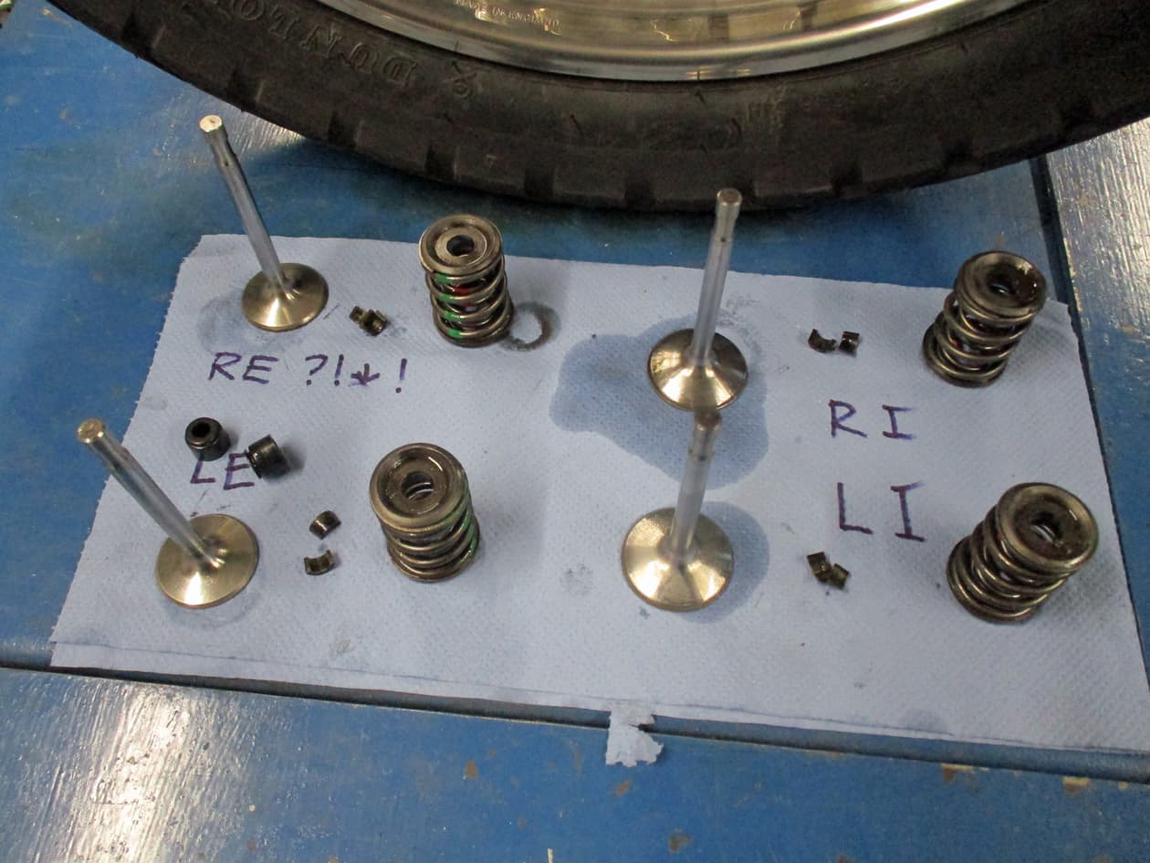

And out with the valves
Just to check that all was well with seating and guides. All looks good.

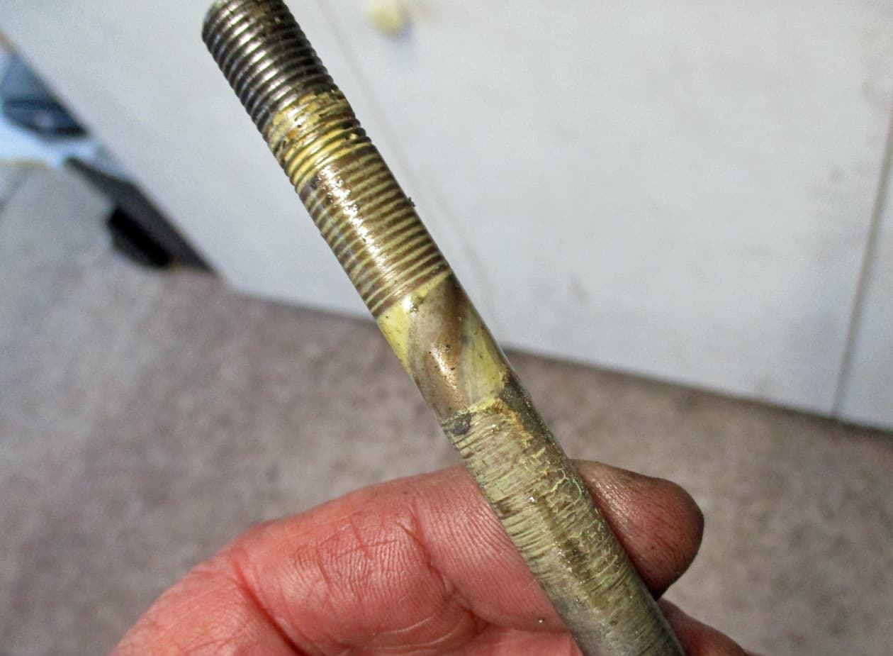

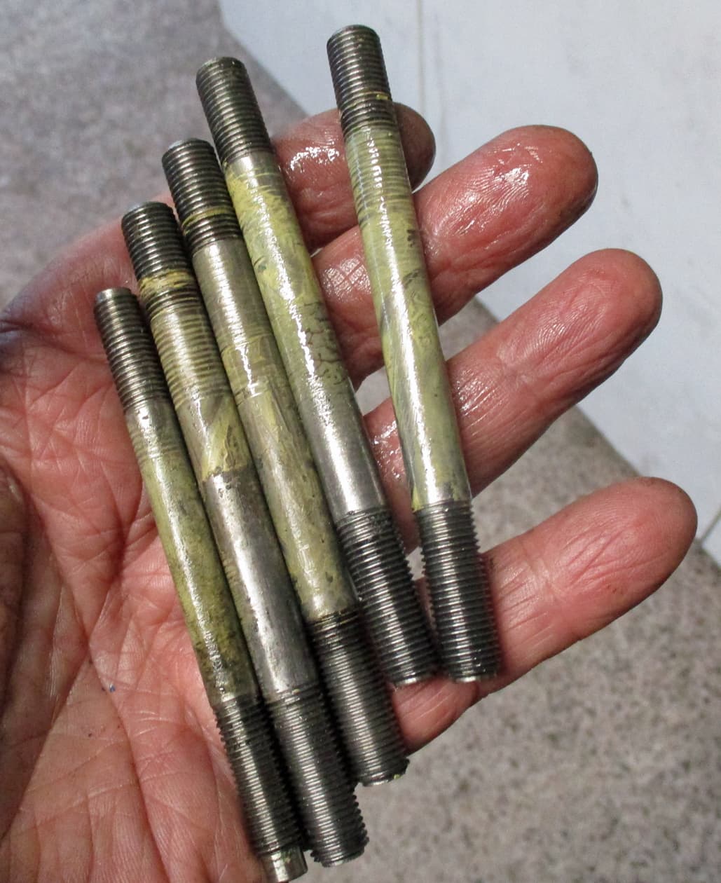

However, remember this stuff I used to stop the alluminium welding itself to the steel bolts…
Well, it had stuck the bolts into the head and was a right git to get the head off.
It had actually gone hard like locktight. I’m glad I didn’t put it on the threads.
Took me ages to clean everything up and get it all off.
Sounded like a good idea at the time. It was expensive as well I seem to remember. It’ll be confined to the bin I think…over… :neutral_face:
