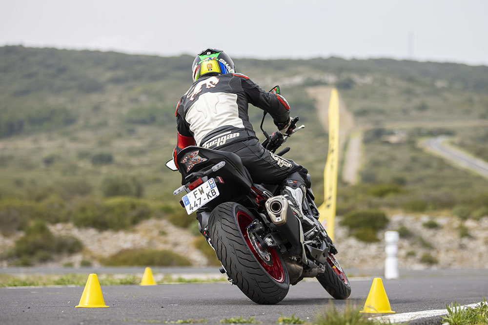

For me it tends to be the point at which they start to fall over that squared edge. I’ve used Bridgestones a lot but do find they square quite easily and you can really feel when they do that. Just changed the V twin Tuono on to Dunlop Roadsmart IVs as the reviews reckon they keep their shape much better. Only time will tell but here is one of the reviews :sunglasses:

DCS, You say the profile has flattened some but it looks ok to me. I recently changed the tyres on my Tracer when the rear had flattened off that much that I thought that maybe the bike would stand up by itself. Far too late, I should have changed them earlier.
Love that image
