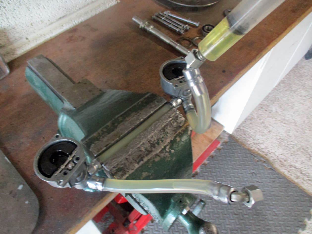

It’s taking ages to tickle these Mk1 Amal carbs and there’s a lot of stand off. The stand off will maybe clear once the bike has a zoom around the block but I want to make sure the carbs are fine before I start thinking about valve timing errors.
So, even though I’d checked float height the usual way, the tickling still wasn’t right. This can be caused by the needle in the carb being too heavy (ie the brass ones - which these aren’t) or float heights. So I wanted to check the heights some other way. I’ve no idea if this will work so not putting this into the “how to” section until tested.
Took off the carbs, then bowls and re-attached the fuel lines. Carefully put the whole set up into the vice to hold them…
Leveled them up
This is where the floats are hanging when dry
And when wet
I thought about filling with water but then as there’s hardly enough petrol to raze the garage involved I ‘injected’ petrol into the fuel pipes until full. And noted where the floats had reached when they had shut off the fuel into the bowl. I could see the petrol flowing into the bowls as I was filling the pipework.
Adjusted the tangs on the floats as per usual. Sucked out the petrol from the bowls
And continued until the floats were sitting at around the required 2mm (80 thou) below the top surface
Considering I’d just adjusted these the other day in the usual manner they were quite a bit off. I’ll see if the tickling is quicker and if I’ve still got the stand off issues. It’s running fine, I just like to have it right.

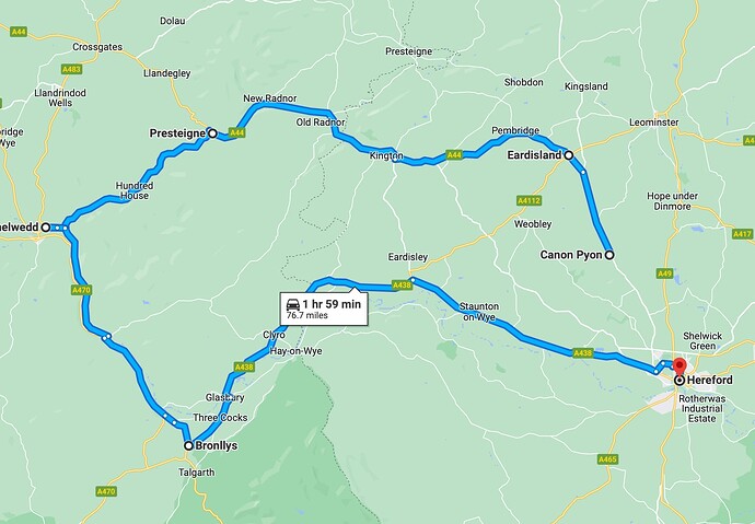

We set out fairly early in this beautiful weather (I am a very early bird, Helmut not at all so my preference definitely won out today) with hardly any traffic on the roads and did a beautiful route through Herefordshire, into Wales on the A44, turned off for Builth Wells rather than heading up to Crossgates and then at Builth Wells headed towards the A438 to head back to Herefordshire. We then stopped at a bike / car meet at a local venue which we tend to go to every month - it wasn’t as well attended as usual, but I suspect lots of people are away on holiday. We had a coffee, a burger from the BBQ, sought shade in our sweltering bike kit and came home. We didn’t stop until the car / bike meet so no scenic photos but it was about as perfect a ride as you can get and I am trying to sell the early starts to @Helmut as by the time we were headed home the roads were busy and packed with enough variety of bad drivers to get your bingo dabber? dibber? (I have no idea) busy to get your Hazards Bingo card looking healthy :grimacing:.
In lieu of photos, I have included part of the route (possibly marginally better than nothing)…
The road to Builth Wells off the A44 is not one I had done before - the A481 - and it was brilliant; it dropped away downhill straight away with a tight bend and had twists and turns, plenty of straight bits and above all gorgeous scenery. Absolutely perfect. Home to enjoy a cider and the garden :+1:.
