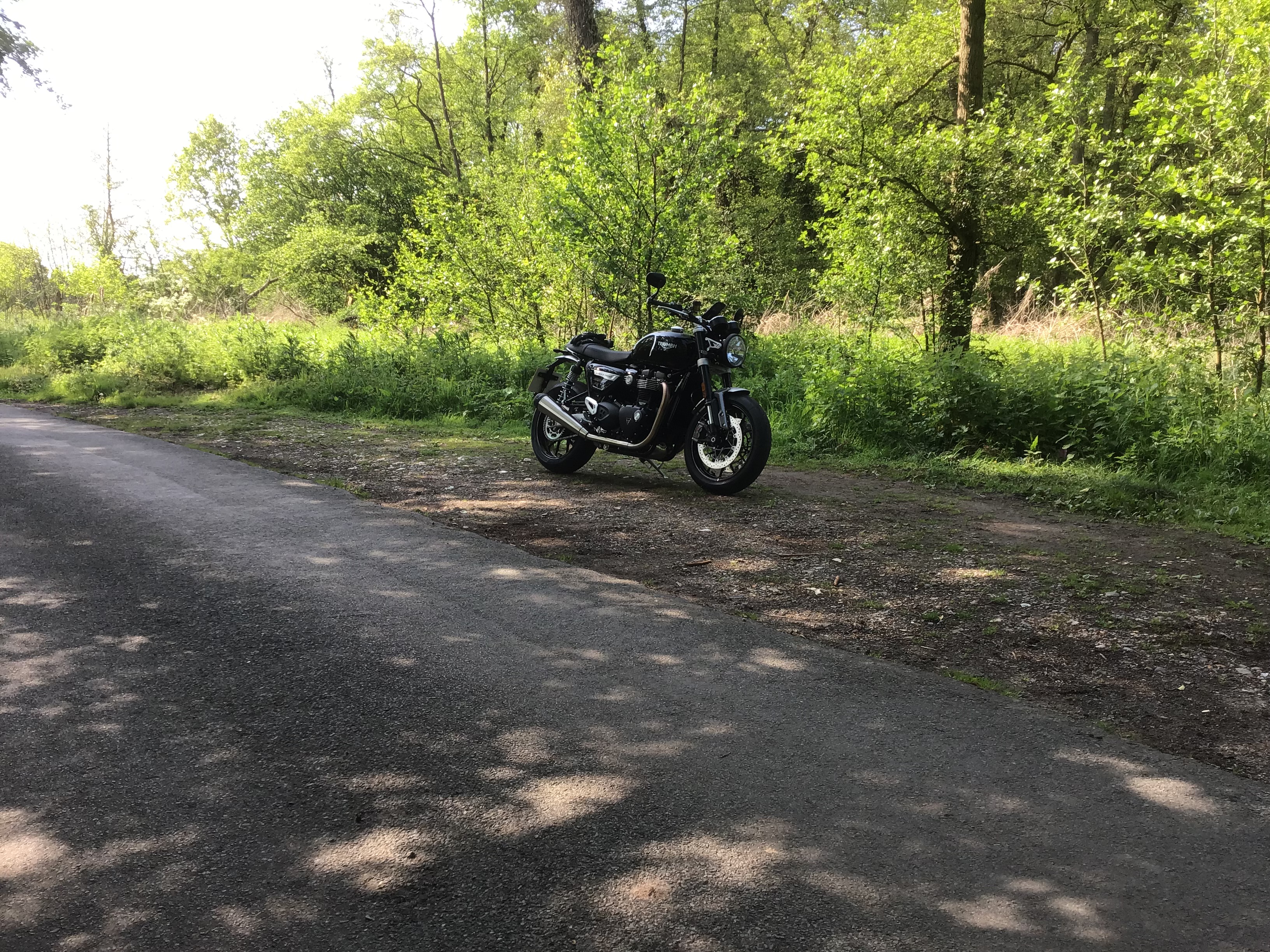

Happy new bike. The speed twin is a cracking bike. Lucky you :grinning:
Looks beautiful, Neal. You’re going to enjoy that!

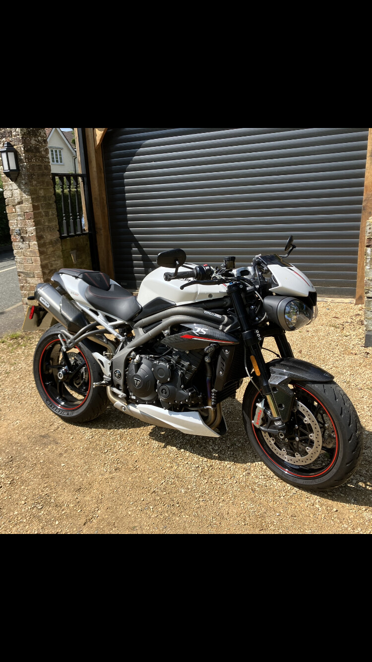

This RS Speed Triple is definitely the Best Bike I’ve ever owned. It does it all.

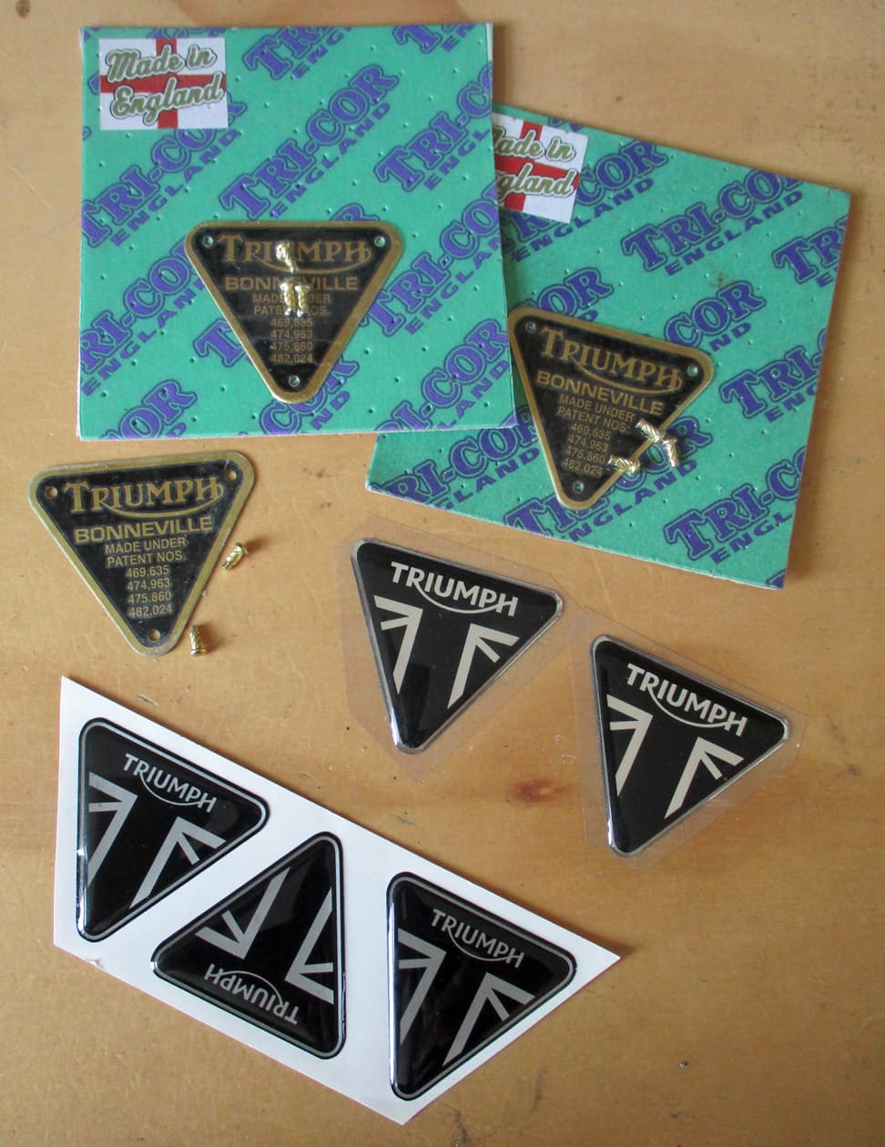

Nothing, been laying 100 ton paving slabs and welding up washing line poles. But these came and reminded me of nice things:
It’s fair to say that my first impressions are positive :smile: :+1:
Apart from keep your hands warm :rofl:

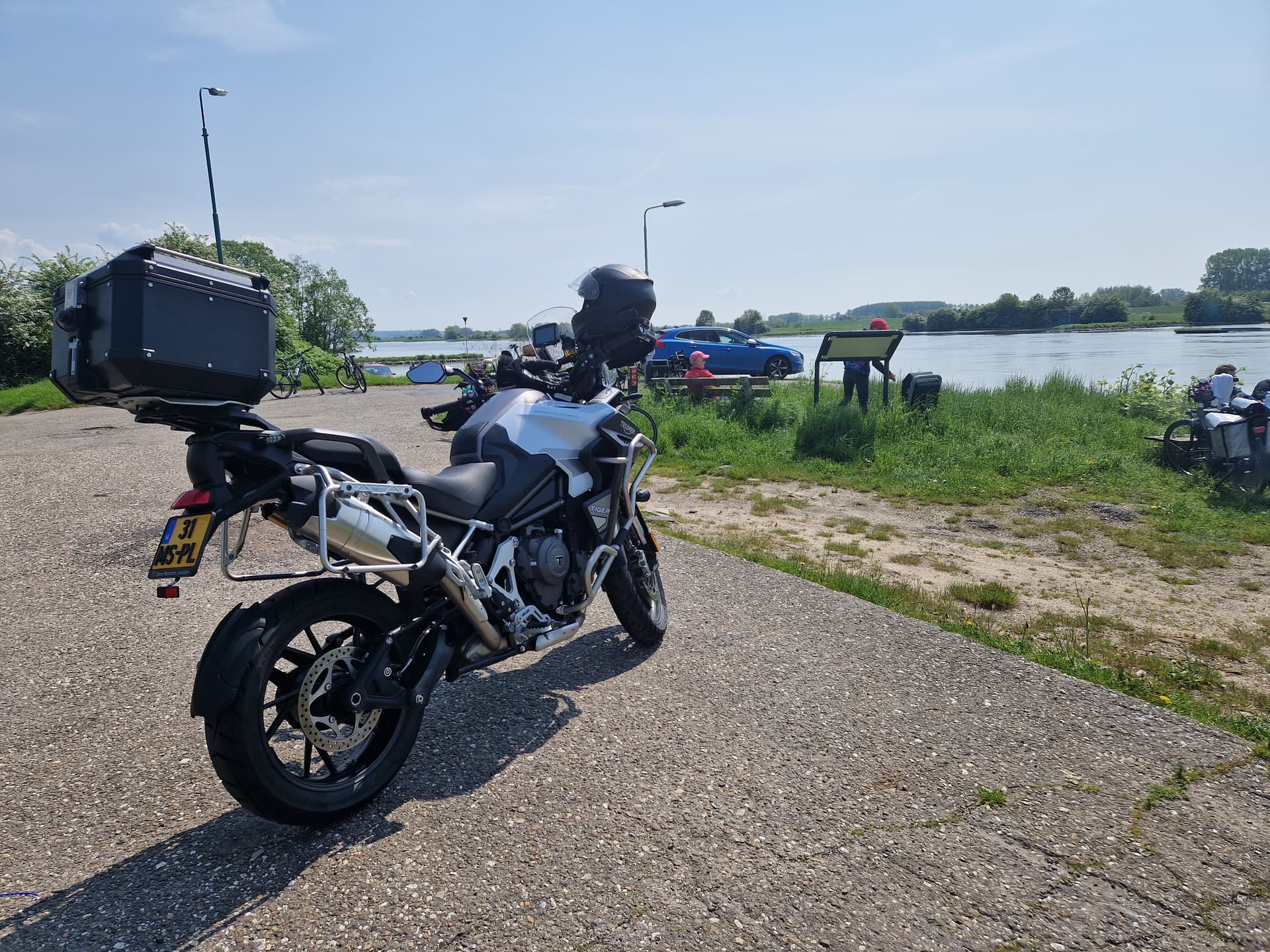

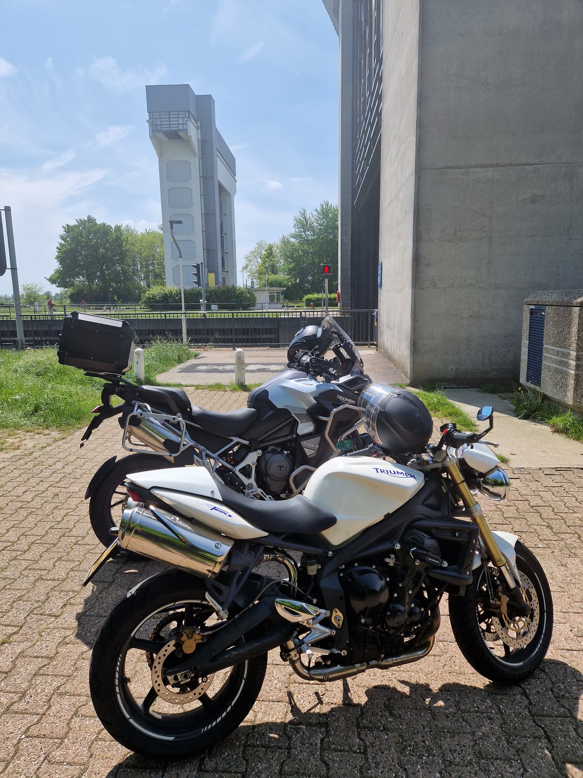

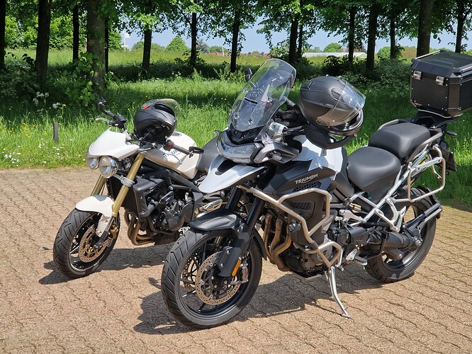

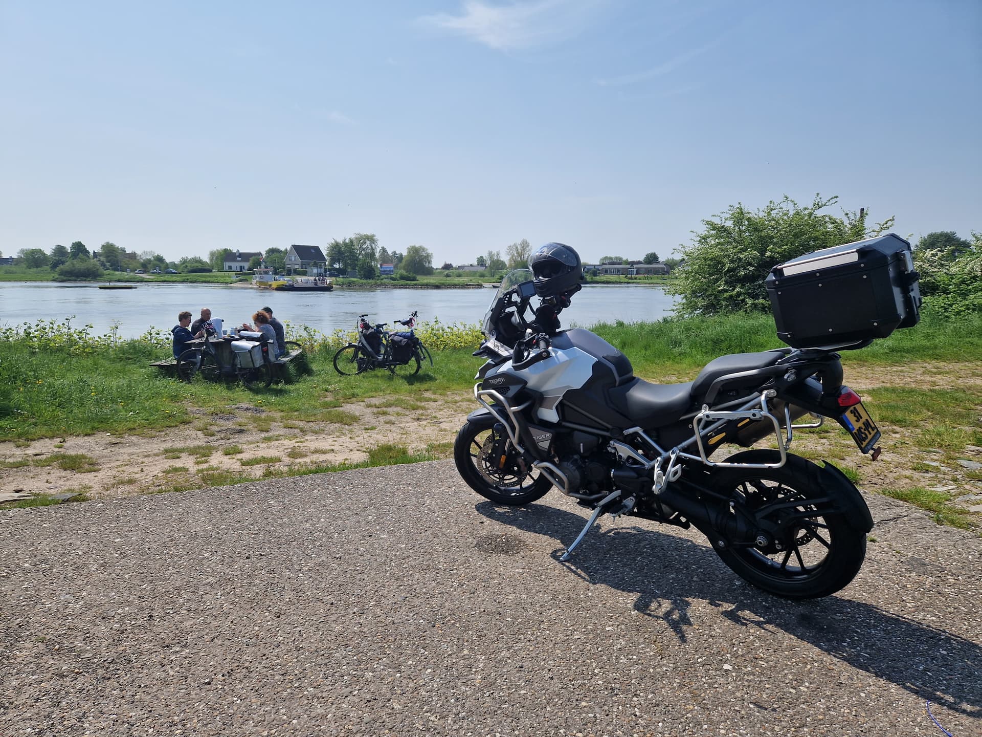

A nice leisurely bimble with mrs. V today.
