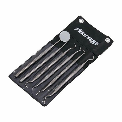

Ever time I do anything on my bike, sooner or later I use one of these.
The peace of mind you would get from a replacement set, would be worth a lot.
