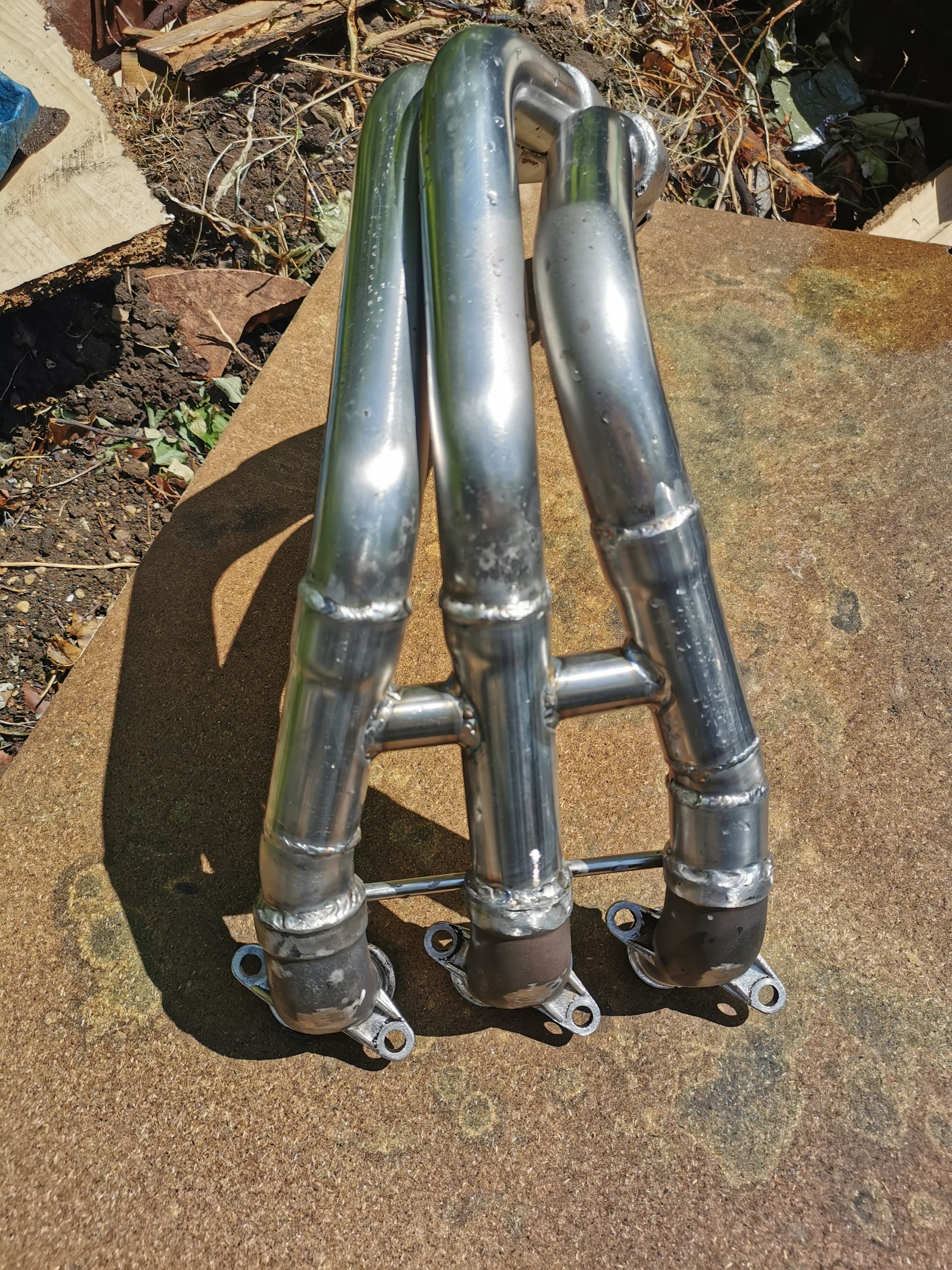

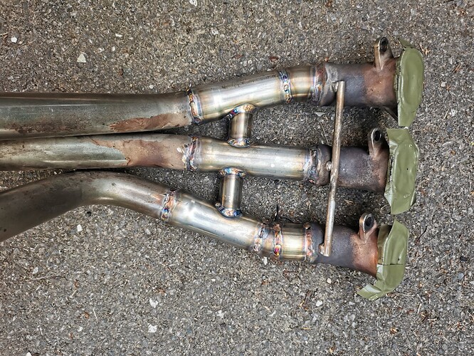

Fabricator got fed up trying to fix old, thin, corroded headers…so he just resectioned them for an extra few quid… So, that’s resectioned/piped headers, Tig purge welded with thicker gauge ss…all in for about £120.
I think I’m very happy!!

Ok…headers cleaned…and going back on…
But…which way does his go ont (it was totally destroyed when old removed so no idea. Mesh in the headers…?
Or mesh towards the can?
Headers are looking great - can’t help you with the mesh I’m afraid…
Nice bit of polishing there, well done.
