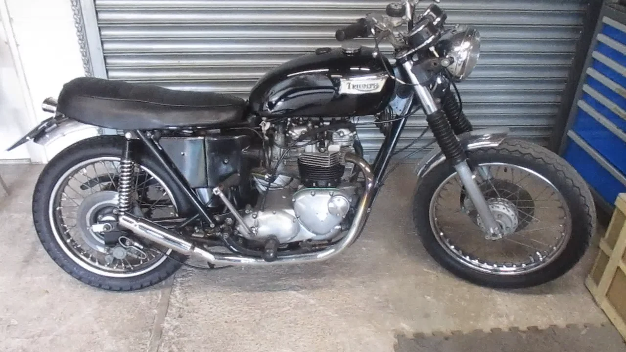

A bit rough but got it going. It’ll have to wait in the queue for bit though.
Time for bed little Ted
This is next
1972 T120V
